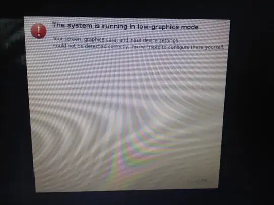

I am trying to install Ubuntu 14.04 on Dell Inspiron 5537, and the installation completes with no errors, but when I boot into Ubuntu I get a popup window saying:
the system is running in low-graphics mode ... device settings could not detected correctly.
This model iscertified by Canonical!
When I choose re-configure, I keep getting the same window!
When I press esc, I get a black screen, and nothing happens.
How can I fix it?

This problem might be occurring because of the graphic driver. So you must consider using proprietary graphic drivers(i.e graphic driver provided by AMD) instead of the default open source driver. But since you are in the live USB mode(i.e in 'Try Ubuntu without installing') if you install the driver and reboot(so that the driver might work) you won't get the driver working, as(going by your question) you haven't set up any persistence. So first thing: you must set up persistence. I will explain how to do this below:

  • Now when you boot in with the USB device and select "Try Ubuntu without installing" you will get "Low graphics mode error" as you have mentioned in your question. Now press Ctrl+Alt+F1. You will get a terminal window. From there connect to the internet.
  • Now type:
sudo apt-get install fglrx fglrx-amdcccle
  • Now restart with:
sudo reboot
  • Now boot again and press "Try Ubuntu without installing" and it must work properly now.
Install Ubuntu and enjoy now!!
