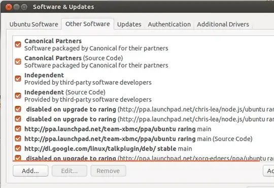

  2. Edit your Software Sources. Simply open the Dash and type Software Sources. That should open the Software Sources window. On the second tab, the one that says Other Software find the PPA for Jupiter and remove that (Both, the source repository and the actual compiled repository for Jupiter).
