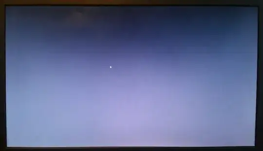

At this point my computer comes up with a grey screen and a mouse. No login, CTRL+ALT+F1 does nothing and the computer is unusable. so I am forced to shut down. I did this at least 8 times and the results are consistent. enter image description here

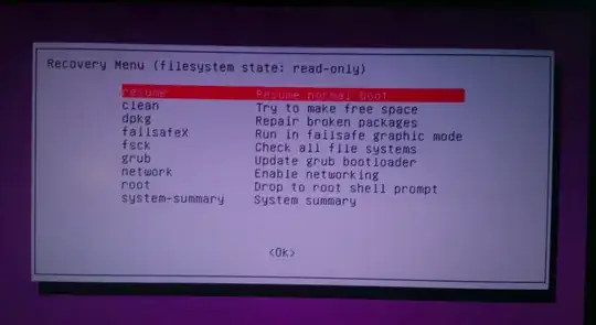

I have many generic recovery kernel options and am able to get here without much issues: enter image description here

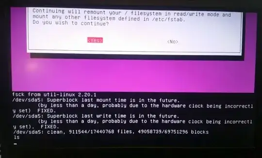

In the recovery screen I tried the option root. I logged in, tried to turn on the wlan0 card (which I can see but cannot get to work). I used this post Connect to WiFi network through Ubuntu terminal - I was able to bring the wlan0 card up but it did not see any wireless networks. Then I tried 'network' but that did not open a terminal. I could not type any commands.... Well I could but they did not execute.

At the recovery menu, select "network - enable networking"
Select that option, and confirm the request to remount the root filesystem in read-write mode. After some status text flashed by, you should arrive at the menu again, but with network drivers loaded. From there, select the option root to "drop to [a] root shell prompt."
Once that is done you can try running apt-get commands.

The menu items in the recovery menu try to provide something useful, but sometimes fail. You can configure your system completely from the root shell prompt though.
  • use the menu option root --- drop to root shell prompt
  • mount everything in read/write mode
    #mount / -o remount,rw
