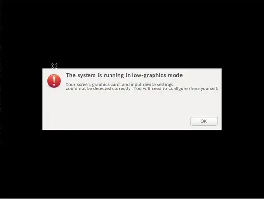

My original problem was that I kept running into
during bootup. Usually, I'd just reboot a few times and the error went away. I even tried following these instructions to resolve it, but it did not help. However, recently the error message persisted after quite a number of reboot attempts, so I decided to continue to boot up. Upon bootup, I found that my WiFi isn't connected and the Wifi Networks under the Networking tab said device not ready. I followed this answer and restarted the network manager with sudo systemctl restart network-manager and the Wifi started to work. On the next bootup, even that didn't work. I followed this answer and commented out the lines at /etc/networks/interfaces, restarted network-manager and all the wifi signals disappeared, except the mobile hotspots. I uncommented the lines and the wifi signals reappeared, however, on a reboot, they disappeared again (the lines are still uncommented). Since then, I have been unable to connect or detect my Router's broadcasts and have no other options but to use my mobile hotspots. I even tried reinstalling the wifi drivers as instructed here, but in vain.
