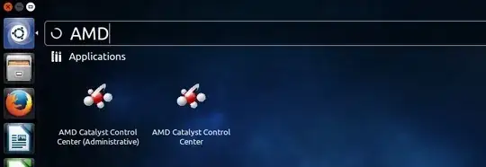

You could switch between AMD / Intel GPU by using the AMD Catalyst Control Center
This could be done by searching AMD in your dash Search AMD in dash

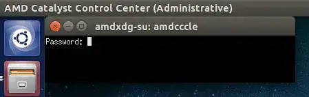

And open the "Administrative" one to switch GPU. You will be asked to enter your password for it. Enter password for administrative mode
However, currently there is a bug affecting it: https://pad.lv/1309550
If nothing happened after you entered the password. Please open a terminal (Ctrl + Alt + t) and run:
sudo amdcccle
You will see this control center, and switch the desired GPU here: control center
