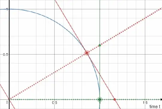

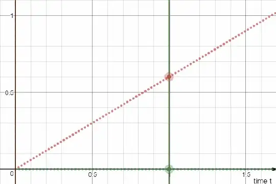

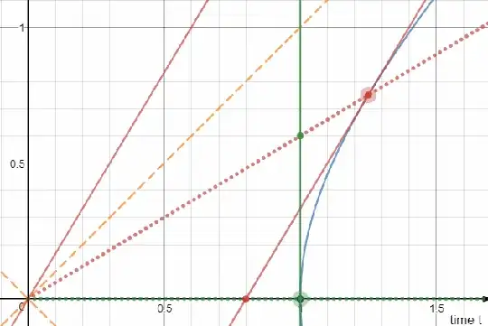

Hopefully you can now see the point of my analogy. In Bill and Charlie’s rest frames they are stationary, so as far as they are concerned they are moving up the time axis at $1$ second per second just like me. But because their time axes are rotated relative to me I observe them to be moving in the time direction at less than $1$ second per second i.e. their time is dilated relative to mine.
Bearing in mind my analogy, to find out what Bill observes we rotate everything to the left to make Bill’s time axis vertical, and now Bill considers himself to be moving up the time axis fastest. Likewise we rotate to the right to make Charlie’s time axis vertical, and we find that Charlie considers himself to be moving up the time axis fastest.
And this answers our question. All three of us think we are moving through time fastest, and the other two people’s time is dilated, because when we measure time we are all measuring time in a different direction. Our clocks differ because we are measuring different things.

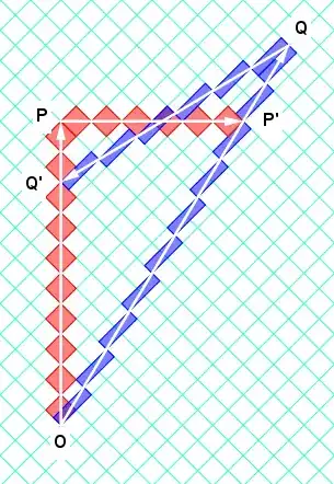

Here are some spacetime diagrams that display the symmetry of time dilation.
These diagrams underlie the various analogies one can use to motivate the symmetry.
First, we draw spacetime diagrams on rotated graph paper so that we can more easily visualize the ticks along the inertial observer worldlines.
In our example,
our observers have relative velocity of $v/c=\tanh\theta=(6/10)$,
and the corresponding time-dilation factor is $\gamma=\cosh\theta=(10/8)$,
where $\theta$ is the Minkowski-angle [the "rapidity"] between the timelike-worldlines.
We have drawn the diagram from Alice's frame. Alice regards P and P' as simultaneous, whereas Bob (traveling with velocity (6/10)c with respect to Alice) regards Q and Q' as simultaneous.
Note that:
  • $\triangle OPP'$ is a Minkowski-right triangle, where $OP$ is Minkowski-perpendicular to $PP'$.
    $$\cosh\theta=\gamma=\frac{OP}{OP'}=\frac{10}{8}$$
  • $\triangle OQQ'$ is a [similar] Minkowski-right triangle, where $OQ$ is Minkowski-perpendicular to $QQ'$.
    $$\cosh\theta=\gamma=\frac{OQ}{OQ'}=\frac{10}{8}$$
RRGP-rotatedGraphPaper-1
In my diagram, the "light-clock diamonds" have lightlike edges and equal area. In addition, the diagonals of the "light-clock diamonds" are Minkowski-perpendicular to each other.
By drawing in the hyperbolas with center at the meeting event $O$, one can see that $PP'$ is tangent to that hyperbola at the event $P$, where "radius vector" $OP$ meets the hyperbola. Similarly, $QQ'$ is tangent to that hyperbola at the event $Q$, where "radius vector" $OQ$ meets the hyperbola. RRGP-rotatedGraphPaper-2-hyperbola
To see that this "tangent is perpendicular to radius" construction is analogous to the Euclidean construction (and to see the Galilean analogue), play around with my visualization https://www.desmos.com/calculator/wm9jmrqnw2 by tuning the E-parameter.
(In this visualization, time runs to the right [like the standard position-vs-time graphs].)
  • Minkowski (E=+1 case) TimeDilationSymmetry-wm9jmrqnw2-Mink
  • Galilean (E=0 case) TimeDilationSymmetry-wm9jmrqnw2-Gal
  • Euclidean (E=-1 case) TimeDilationSymmetry-wm9jmrqnw2-Euc
The first diagram is based on Fig. 17 in my paper "Relativity on Rotated Graph Paper" [American Journal of Physics 84, 344 (2016)] http://dx.doi.org/10.1119/1.4943251

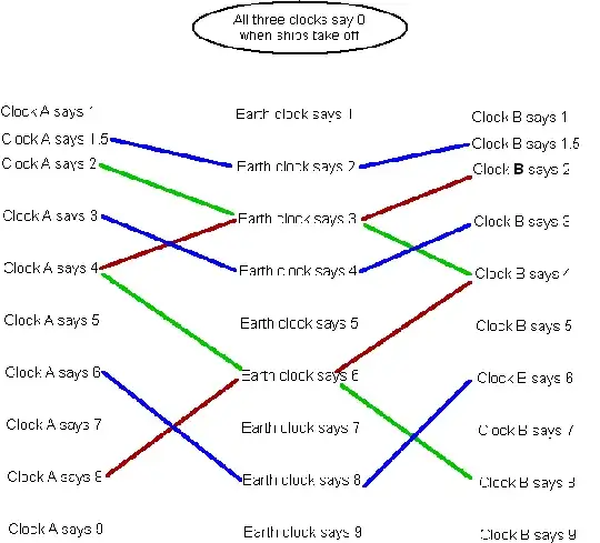

I'm assuming the ships take off simultaneously from earth, with all three clocks set to 0. Events connected by blue lines are simultaneous according to the observer on earth. Events connected by red lines are simultaneous according to the observer on ship A. Events connected by green lines are simultaneous according to the observer on ship B:
(Note: these times are approximations; to make this fully realistic, I'd have to show events happening at times like 1:47, which I'll have rounded off to 2:00.)
The earthbound observer says things like this:
I see by my clock that it's now 4:00. At this moment both ship clocks say 3:00. They are running slow.
Or
I see by my clock that it's now 8:00. At this moment both ship clocks say 6:00. They are running slow.
The captain on Ship A says things like:
I see by my clock that it is now 4:00. At this moment, the earth clock says 3:00. It is running slow. Also at this moment, the B-clock says 2:00. It is running even slower.
Or:
I see by my clock that it is now 8:00. At this moment, the earth clock says 6:00. It is running slow. Also at this moment, the B-clock says 4:00. It is running even slower.
The captain on Ship B says things like:
I see by my clock that it is now 4:00. At this moment, the earth clock says 3:00. It is running slow. Also at this moment, the A-clock says 2:00. It is running even slower.
Or:
I see by my clock that it is now 8:00. At this moment, the earth clock says 6:00. It is running slow. Also at this moment, the A-clock says 4:00. It is running even slower.
Where's the alleged paradox?

$$ \frac{\boldsymbol \tau^{\mathsf A}{[ \, \circ \mathsf B, \circ \mathsf Q \, ]}}{\boldsymbol \tau^{\mathsf B}{[ \, \circ \mathsf A, \text{simultaneous to } \mathsf Q \! \circ \! \mathsf A \, ]}} = \sqrt{ 1 - \left( \frac{u}{c} \right)^2 }.$$
And likewise, or in other words: symmetric to instance (a):
(b)
$\mathsf B$'s duration from having met $\mathsf A$ until having met $\mathsf P$ is less than $\mathsf A$'s duration from having met $\mathsf B$ until simultaneous to $\mathsf P$ having met $\mathsf B$. Or symbolically, and more quantitatively:
$$ \frac{\boldsymbol \tau^{ \mathsf B}[ \, \circ \mathsf A, \circ \mathsf P \, ]}{\boldsymbol \tau^{ \mathsf A}[ \, \circ \mathsf B, \text{simultaneous to } \mathsf P \! \circ \! \mathsf B \, ]} = \sqrt{ 1 - \left( \frac{u}{c} \right)^2 }.$$
(A corresponding quantitative derivation was of course already given by Einstein 1905; specificly there. However, the notation I've used above hopefully makes the relevant symmetry better recognizable. Besides, I recommend the derivation shown here, sec. 2.)
This concludes my answer to the question stated in the OP title.
p.s.
"Twin $\mathsf A$ observes twin $\mathsf A$’s time to be dilated so his clock runs faster than twin $\mathsf B$’s clock. But twin $\mathsf B$ observes twin $\mathsf A$’s time to be dilated so his clock runs faster than twin $\mathsf A$’s clock. [...]"
This quoted description is defective.
Either -- perhaps trying to argue sympathetically -- the two described cases are meant to correspond to the two cases (a), or (b), resp., of my answer above. (Even though in my above answer there was no mentioning at all of "clocks", or even of "one clock running faster than another", or somesuch.)
If so, then the quoted description is poorly worded: it fails to convey the actual symmetry, and it can easily be mistaken for an absurd statement.
Or -- even worse: it is actually meant to be an explicitly absurd statement.
