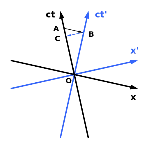

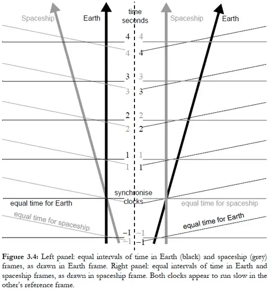

This is why the Loedel Diagram was invented. It is the Minkowski Diagram drawn by the the observer who sees A and B moving at $\pm v'$ with $v = 2v'/(1+v'^2)$:
A sees B's clock running slower and B sees A's clock running slower because when they are separated, their planes of simultaneity are different.
That they both see the other person's "t" coordinate as less than their's is the same phenomenon that occurs when two cars are driving opposite the directions on the highway: they both see the other with a larger "left" coordinate than their own.

It is not a contradiction because the observers have different notions of synchroneity, as seen in this diagram enter image description here
