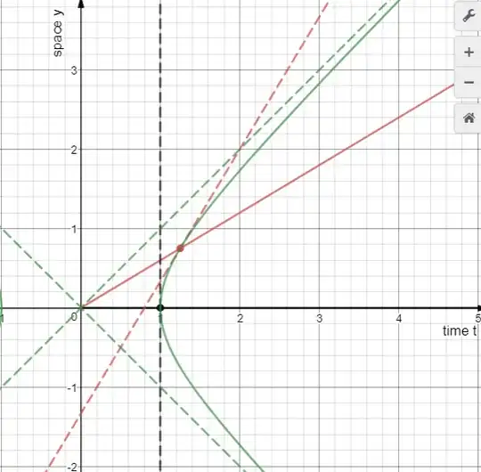

A spacetime diagram can display this symmetry
https://www.desmos.com/calculator/ti58l2sair tangents to hyperbolas in Minkowski space
When an observer's worldline meets that unit hyperbola [marking one tick of that observer's clock], the tangent at the intersection defines the events simultaneous with the intersection event according to that observer.
Now for the symmetry...
Here Alice is the GREEN observer is at rest
and the Bob is the RED observer moving with velocity (3/5)c.
So, $\gamma=1/\sqrt{1-v^2}=5/4$.
Note how an observer's line-of-simultaneity cuts the other observer's worldline BEFORE that observer reaches the hyperbola... and that fraction is the same for each observer. In fact, that fraction is $1/\gamma=$1/(time-dilation factor).
Specifically,...
  • Alice, using the black dotted line [her line of simultaneity], says her clock reads $t=1$ when Bob's clock reads $t'=4/5=1/\gamma$. (So, Alice's says her clock reads $t=\gamma$ when Bob's clock reads $t'=1$.)
  • Bob, using the red dotted line [his line of simultaneity], says his clock reads $t'=1$ when Alice's clock reads $t=4/5=1/\gamma$. (So, Bob's says his clock reads $t'=\gamma$ when Alice's clock reads $t=1$.)

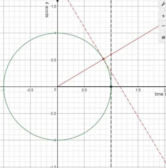

If you tune "E" to -1, you can see the Euclidean analogue. tangents to circles in Euclidean space
