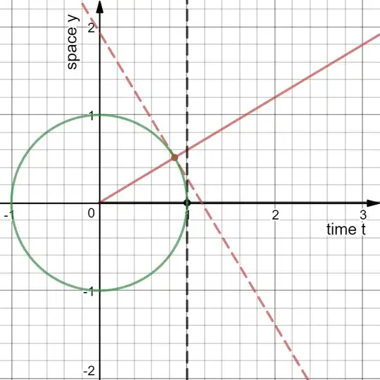

Euclidean analogy
This shows a unit circle and two radial directions, the black one horizontal and the red one sloped with a positive angle. Think of each radial direction as the straightline path of a surveyor (each making his own map of the plane) and their dashed meterstick that each carries perpendicular to his path. Perpendicularity is defined using tangency to a circle.
The grid is already aligned with the black surveyor.
The black surveyor would assign t-coordinate=1 to every point on his dashed meterstick, in particular the point (1.0, 0.6) where the red path intersects the black dashed meterstick. However, the red surveyor would have assigned that point a t-coordinate larger than 1 on his map since he has already passed the unit circle.
Similarly... The red surveyor would assign t-coordinate=1 to every point on his dashed meterstick, in particular the point where the black path intersects the red dashed meterstick. The black surveyor would have assigned that point a t-coordinate larger than 1 since he has already passed the unit circle. (By symmetry, the value of this larger-than-1 t-coordinate is the same as the value from the red surveyor. In fact, this larger-than-1 value is 1/cos(arctan(slope)). With slope=0.6, that value is 1.1662.)
Presumably, no problem here because we are used to Euclidean geometry.

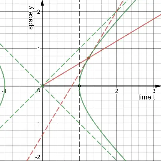

In the visualization, Go there and set the E-slider to +1
Special Relativity case
Rather than surveyors, the radial lines are now worldlines of inertial observers (making spacetime diagrams [position-vs-time graphs]).
These hyperbolas are the analogues of the circles in Euclidean geometry. They mark off all of the events of "one-tick" for each wristwatch traveling inertially [each with different velocities] from a common starting event O.
When an observer's worldline meets that unit hyperbola [marking one tick of that observer's clock], the tangent at the intersection defines the events simultaneous with the intersection event according to that observer.
So, the black dashed line has t-coordinate=1 on the diagram drawn by the black observer, in particular the event (1.0, 0.6) where the red worldline intersects the black dashed meterstick. However, the red observer would assign that event a t-coordinate smaller than 1 on his diagram since he has not yet reached the unit hyperbola. That value is 1/cosh(arctanh(slope))=0.8 . Physically, this is 1/timeDilationFactor.
...and similarly for the red dashed line.
So, the special relativity case is an analogue of what happened in the Euclidean case.

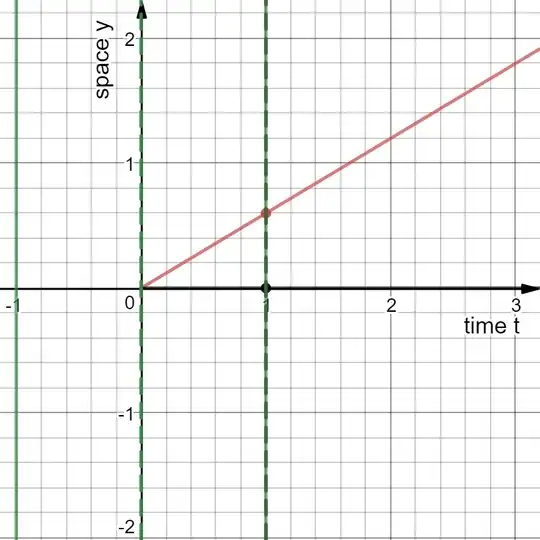

In the visualization, Go there and set the E-slider to 0 , the Galilean case.
Galilean case
This "circle" in the Galilean case is a vertical line-- the t=1 line. All tangent lines to this circle coincide. All observers agree on assigning t=1. This is absolute simultaneity.
