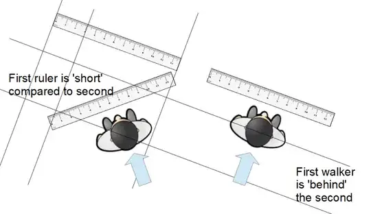

There's a very simple analogy with people's everyday experience that explains the basic idea of how it works.
Consider two people walking across a field at the same speed but in slightly different directions. Because they're walking at a constant speed, their movement in the forwards direction is analogous to time, and distances sideways can be considered analogous to space.
Walkers in field
However, each walker is facing in a different direction and so has a different definition of forwards and sideways - or time and space. When the second walker looks at the first, he sees his ruler tilted, and hence 'shorter' according to his own definition. He also sees the first walker gradually falling behind himself. Because the system is symmetric, the first walker sees the second walker in exactly the same way.
This property of both walkers seeing the other gradually falling behind themselves as they walk across the field, progressing more slowly in the 'forwards' direction, is exactly analogous to moving clocks both running slower than the other. The reason this is possible is that they are using different definitions of 'time', pointing in different directions in spacetime.
The geometry of spacetime combines space and time like the geometry of the field combines 'forwards' and 'sideways'. The main difference is that spacetime has a different rule for Pythagoras' Theorem, with a sign change. On the field, the rule is $d^2=f^2+s^2$: the distance along a diagonal squared is equal to the distance travelled forwards squared, plus the distance travelled sideways, squared. In spacetime, it would be $d^2=f^2-s^2$. Time and space contribute with opposite signs. This changes the geometric details somewhat, so be careful about taking the analogy too literally. However, it works quite well for many situations.
The time experienced by a moving clock is the length of its path through spacetime. Travelling from A to B by a straight path or a wiggly path gives different lengths, and hence each traveller can take a different amount of time to get there, even though the routes both start and end at the same times and places. We're already familar with thinking of lengths and distances behaving this way, it's not that odd - we're just not used to thinking of time working in the same way.
