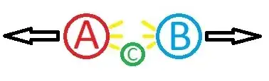

I am trying to wrap my head around some of the implications of relativity. Hopefully somebody can help enlighten me with a specific example I am wondering about:
We have 2 objects, A and B, that are traveling away from each other and emitting light towards each other. We also have a "stationary" object, C, that will be one of our observers stationed between A and B.
According to C, A is traveling at 0.6c in one direction and B is traveling at 0.6c in the opposite direction. From C's perspective there is 1.2c relative motion between the objects.
I am trying to figure out the perceived behavior of the light from the reference frame of the 3 different objects. I believe A and B will see the same thing so are equivalent, this leaves 2 different reference frames.
My assumption is C will see 1.2c relative motion between the two objects, but since all light is traveling at 1c from C's reference, the light from A will eventually reach B. From C's point of view, is there a 0.4c relative motion between A's light and B? My thinking is that C sees A's light going 1c towards B but B is receding at 0.6c so there is 0.4c difference. I am not confident in these assumptions. Does the time-dilation effect of the relative motion between these objects alter this?
The situation from A's point of view is harder for me to think about. B cannot seem to be moving faster than c from A's (or anybody's) point of view. How fast DOES B appear to be moving away from A (in A's point of view)? How does this affect A's perception of light from B (or vice versa)?
Finally, if an object leaves A heading towards B at 0.61c (relative to A), will it ever reach B? From C's perspective I don't think it does (C will see the object approaching at 0.1c, clearly not fast enough to approach B). If not, what speed would an object need to have, relative to A, to reach B? Does whether or not this object appears to reach B depend on your reference frame?
I apologize in advance if this is too many questions at once, or otherwise inappropriate. I have attempted to solve this for myself by searching this site and google but haven't found anything that clicks with me yet. If there is already a question/answer on this sight that could help me better understand this type of thing I would love to learn about it. I would really like to gain an intuitive understanding of how these things work, so analogies and metaphors are appreciated. That said, as an engineer I am not afraid of mathematical explanations, just understand that if I ever studied this stuff it was many decades ago and long forgotten...so baby steps.

My assumption is C will see 1.2c relative motion between the two objects, but since all light is traveling at 1c from C's reference, the light from A will eventually reach B. From C's point of view, is there a 0.4c relative motion between A's light and B? My thinking is that C sees A's light going 1C towards B but B is receding at 0.6c so there is 0.4c difference.
Yes, of course this is right.
Time dilation is about the comparison between the way things look in one frame and the way they look in another. But you are doing this calculation in a single frame, so time-dilation has nothing to do with it.
As for how things look to $A$: In $A$'s frame, $B$ is moving away at a speed of about $.88c$, well below the speed of light but well above $.61c$ --- so an object sent by $A$ toward $B$ at a speed of $.61c$ (as calculated in $A$'s frame) will never reach $B$. To see where the $.88c$ comes from, there are plenty of good places (including many on this site) to read about the velocity addition formula (that's the phrase to search for) so I won't take up space repeating that here. But I did want to post an answer to address the very specific confusion about the role of time dilation, noted above.
WillO
  • 18,387
Technically, what A and B see are "symmetric" or "isomorphic", not the same or equivalent. While A and B have the same speed relative to C, the sign is different, and so the velocities are different.
Yes.
No. One of the basic postulates of relativity is that all observers measure light as travelling at $c$ in a vacuum. A, B, and C all measure the light from A as travelling at $c$. Time dilation doesn't affect that. And $0.6c$ is the velocity of $B$ as measured by $C$, so we already have the velocity in that reference frame, and don't need to use time dilation to find it. Also, "Lorentz transformation" is more accurate than "time dilation". Measured velocity is affected both by the change in measured time and measured space.
You can use the velocity addition formula or a calculator. This gives $0.8824$.
As I mentioned above, light always travels at $c$.
This depends on whether it's traveling faster than the relative velocity. To find that out, you need all the velocities to be in the same reference frame. If you enter 0.61 and -0.6 in the calculator, that will convert $0.61$ to C's reference frame. The velocity is $0.015773c$, which is definitely lower than $0.6c$. Or you can stay in A's reference frame, and compare $0.61$ to $0.8824$. The differences in velocities are different in the two reference frames, but both agree that it's not fast enough to catch up.
There are a few errors there. First, $0.61-0.60$ is $0.01$, not $0.1$. Second, when you add or subtract velocities, you have to use the velocity addition formula (subtraction is just addition of the negative), which gives the $0.015773c$ above.
It would have to be above the relative velocity of $0.8824c$
No. A different reference frame is just a different coordinate system. They don't differ in actual physical questions such as whether two objects meet. The event of the object reaching B will have different time and space coordinates in different reference frames, but all reference frames agree as to whether it happens.
