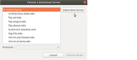

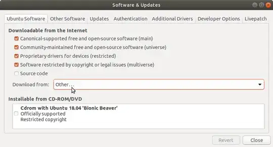

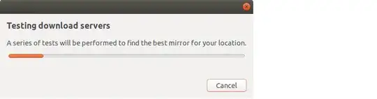

Another way to solve the a Temporary failure resolving error message is by choosing a different update server mirror.
  1. Open Software & Updates from the Dash and select Ubuntu Software tab -> from the dropdown menu to the right of Download from: select Other....
    Software & Updates
  2. Click the Select the Select Best Server button to select the best download server.
    Select best server
  3. A series of tests will be performed to find the best mirror for your location.
  4. Click Choose Server to select the recommended server.
