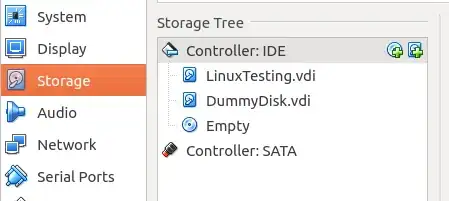

As it is a virtual machine we may just intall Ubuntu to another virtual drive an then attach and mount the old drive to this new virtual machine. We then can just copy our data over.
Two virtual drives attached to a VM
Of course we could also re-install Ubuntu without formatting the drive and without deleting data in the HOME directory (chose "upgrade" option from the installer) but above procedure may be safer.
