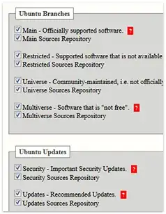

I was facing the same problem and figured the easiest solution is to reset the sources of /etc/apt/sources.list. To do so, follow these steps:
  1. Obtain the release of your Ubuntu version, type into the console:
    lsb_release -r
  2. Go to http://repogen.simplylinux.ch/ to generate a new sources.list
  3. Select your country & release
  4. Check the first 12 boxes:
    All Ubuntu Brances + Security & Updates
  5. Generate and copy your new list
  6. Backup the old file to sources.list.old
    mv /etc/apt/sources.list /etc/apt/sources.list.old
  7. You can now either open vi to save the new list by doing:
    vi /etc/apt/sources.list
    (Paste and save using `:wq`)
    Or by copying and pasting into your terminal the "curl" command (including a unique URI for your updated source list) as it is presented under "Sources List" on the repogen output page.
  8. G2G, retry running apt-get update

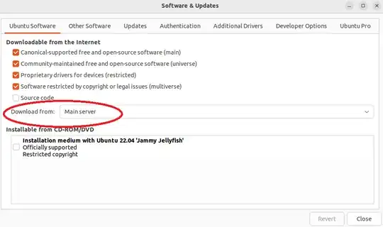

As http://repogen.simplylinux.ch/ does (did?) not have options for anything beyond 18.04
Hit WinKey/Super-key and start typing Software & Updates - a pinkish icon will appear early in your typing; select or click on it.
In the /Ubuntu Software\ -tab, select either main site or something else (different, preferably local) from what you have had there.
NOTE: Your problem may also be related to what is in /Other software\ -tab.
Quick fix: Remove the tick for it.
Then allow updating, or do sudo apt update & sudo apt upgrade from terminal / Shell / bash.

I've had this happened before, Go to the update manager "software and sources" and download the updates from your home country server or try a different country's server, otherwise from the main server. Usually this solves it for me until it happens again.
