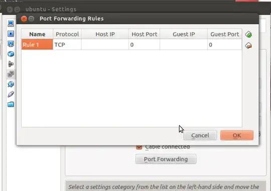

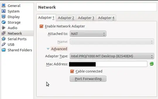

Here is a snapshot of my VM's Network settings (only Adapter 1 has any information populating its fields, so I assume my VM has only 1 adapter):

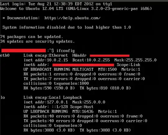

Here is the output when I run ifconfig from the terminal:
And here is the output when I run route from the terminal:

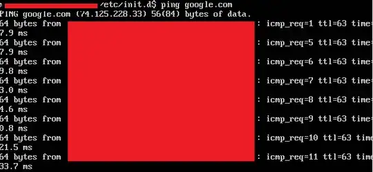

Running ping google.com:

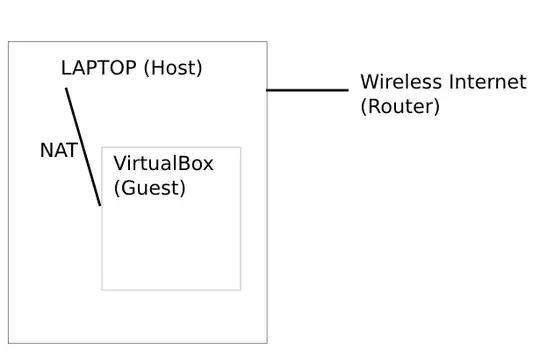

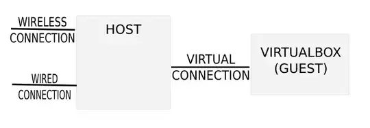

The way I see the scenario is like this:
Now to correctly see where the problem is, in this case, we need to first check from the outer networks to the inner networks.

  • There is no wireless connection inside the virtualbox environment. All "virtual" connections are in reference to cable/wired connected ones. So when you enable a Network card in your virtual guest, it is a virtual wired connection you are creating not a virtual wireless one.
  • The virtual connection from Host to Guest is independent of the type of connection your Host is connected to (Physically connected). If the host is connected via a wired or wireless connection, it does not matter or affect the virtual connection made from the Host to Guest because wired and wireless connections are used in the same way inside the Guest. Something similar to the following image:
  • If your host does not have internet access, your guest will not have it. The same goes that if your host has internet access and your connection from Host to Guest permits sharing the internet, then the guest will most probably have internet also (Default behavior with Virtualbox).

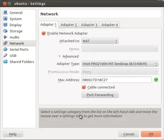

  • I will be using Virtualbox 4.1.20 which looks different from the one you are using (Might be same, I do not know). I will add the network image just to help and show the differences:

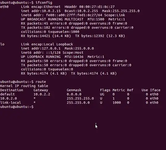

  • The output from the Guest is the following with ifconfig and route:

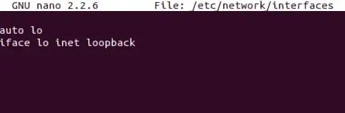

  3. Verify that /etc/network/interface is correct. My example would be:
  4. Change the Adapter Type in the Network Options in the Virtualbox Configuration Window.

Also, even if you're running your VM on a laptop which connects via wifi, you don't need to configure wifi on the guest machine - VirtualBox emulates a "wired" network adapter, so your guest OS thinks it runs on a machine which is connected to LAN with a cable.
Configuring networking in VirtualBox is a broad topic (although typical setups normally work out of the box), you need to make sure your VM has a network adapter configured in VM's properties etc.
See http://www.virtualbox.org/manual/ch06.html for more details.
The default VirtualBox setup (NAT) creates a "private" network between your host and guest machines, with the host machine forwarding all traffic coming from the guest machine outside and sending responses back to the guest (similarly to how your router connects your laptop to Internet). The guest does not have an individual IP address in your LAN and can not be accessed from outside your laptop, but you can access Internet from the guest because packets are translated into the LAN by the host machine and then into internet by the router. This explains why you don't see a separate device in your router's settings

This is what worked for me:
trying to set up wireless did not work
adding network property details on Ubuntu VM and changing on windows the same did no work
though host was wireless, guest (ubuntu VM) acts as if it is connected by virtual cable so following solved the problem:
Ubuntu VM window > Devices > Network > Network Settings ... > check the box for Cable Connected

I also run ubuntu desktop and server on VirtualBox. And i was having the same issue like you. My workaround was not to set up network card in VirtaulBox as NAT, but as Bridged Adapter.
I hope it help!;)
PS: from the link Serghey posted (VirtualBox manual):
"Bridged networking This is for more advanced networking needs such as network simulations and running servers in a guest. When enabled, VirtualBox connects to one of your installed network cards and exchanges network packets directly, circumventing your host operating system's network stack."

This issue is essentially due to a the allocation of the same IP addresses to both the Host WiFi adapter (by the wifi router's DHCP server) and the Guest interface (by the VirtualBox DHCP server under Nat networking).
From the VirtualBox documentation about the integrated DHCP server Fine-tuning the VirtualBox NAT engine:
In NAT mode, the guest network interface is assigned to the IPv4 range 10.0.x.0/24
by default where x corresponds to the instance of the NAT interface +2. So x is 2
when there is only one NAT instance active. In that case the guest is assigned to the
address 10.0.2.15, the gateway is set to 10.0.2.2 and the name server can be found at
10.0.2.3.
Looking at your host's WiFi adapter's IP address you will find that the address assigned to it is from the 10.0.2.0/24 network range as well.
This is the reason for the issue as now the Nat driver for VirtualBox is confused by the fact that the host and guest addresses are from the same subnet.
To fix this you can change the subnet served out by the VirtualBox DHCP server using the VBoxManage command(while the VM is powered down):
Vboxmanage modifyvm VMName --natnet1 "198.162/16"
And you're good to go(as 198.162.0.0 is almost never used in DHCP servers in SOHO network devices).
