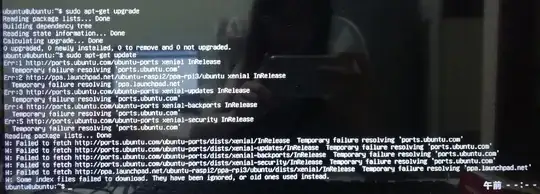

The image are here for the evidence:
real fail to fetch image
err1: http://ports.ubuntu.com/ubuntu-ports xenial InRelease
Temporary failure resolving 'ports.ubuntu.com'
err2: http://ppa.launchpad.net/ubuntu-raspi2/ppa-rpi3/ubuntu  xenial InRelease
Temporary failure resolving 'ppa.launchpad.net'
Reading Package lists...Done
W:Failure to fetch http://ports.ubuntu.com/ubuntu-ports/dists/xenial/InRelease Temporary failure resolving 'ports.ubuntu.com'
W: Some index files failed to download. They have been ignored, or old one used instead.
How can I fix it??
Thank you for all your help!

This is likely because you don't have network connectivity on the Raspberry Pi. First check if you actually can reach the Internet via:
ping google.com
If this fails then you need to connect the Raspberry Pi to the Internet first.
