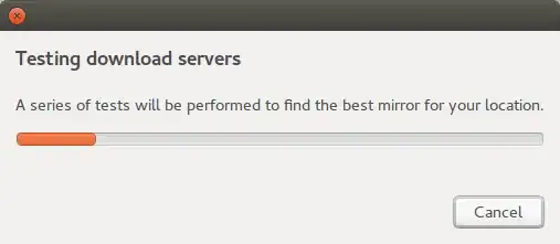

Choose Select best server
SnU2

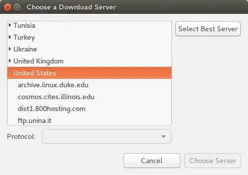

You'll see this:
SnU3
Click Choose Server to select the recommended server
