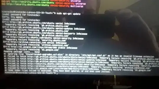

But when I ran the command
sudo apt-get update && sudo apt-get upgrade
, I get the following error message (I could only take a picture of it as in that computer only the terminal is working)
screenshot of "Temporary failure resolving" errors from APT
Basically it is saying that it failed to resolve a few packages (e.g. temporary failure to resolve 'gb.archive.ubuntu.com')
I have then found something at apt-get update fails to fetch files, “Temporary failure resolving …” error, which I believe is pretty much what I have been experiencing (failure DURING dist upgrade).

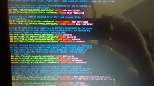

However, I noticed that ALL the entries from my sources.list have the name "xenial" after it, therefore I'm afraid closing all the entries from my source.list is not the best option. A picture of my sources.list file can be found below:
screenshot showing contents of sources.list in a terminal-based text editor
Or do anyone of you believe it can be a temporary DNS issue? Or any other thoughts (I have a feeling it has something to do with my sources.list)?

The sources.list seems fine and its most likely an issue with the DNS.
You can add 8.8.8.8 as your temporary DNS and see if it helps by running the following command
echo "nameserver 8.8.8.8" | sudo tee /etc/resolv.conf > /dev/null
Then run the following
sudo apt-get -f install
sudo apt-get update
If this fixes your temporary resolving messages then either wait and see if your ISP fixes the issue for you or you can permanently add a DNS server to your system:
echo "nameserver 8.8.8.8" | sudo tee /etc/resolvconf/resolv.conf.d/base > /dev/null
8.8.8.8 is Google's own DNS server.
