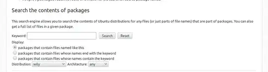

You can search the contents of packages included in the various Ubuntu releases on the Ubuntu Packages website. Look under the heading "Search the contents of packages".
For example, here are the search results for libnss3.so in focal (20.04):
http://packages.ubuntu.com/search?searchon=contents&keywords=libnss3.so&mode=exactfilename&suite=focal&arch=any

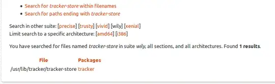

You mean, which package and not which application. The application is your package manager, e.g. Software Center.
Using dpkg:
dpkg -S /usr/lib/tracker/tracker-store
dpkg -S tracker-extract
dpkg -S tracker-miner-fs
Example
% dpkg -S /usr/lib/tracker/tracker-store
tracker: /usr/lib/tracker/tracker-store
Using apt-file:
apt-file search /usr/lib/tracker/tracker-store
or also possible:
apt-file search --regex /tracker-extract$
apt-file search --regex /tracker-miner-fs$
Example
% apt-file search /usr/lib/tracker/tracker-store
Or online here, in the section Search the contents of packages.
Example
