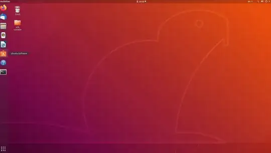

Here is my desktop screenshot (Notice the left dock)

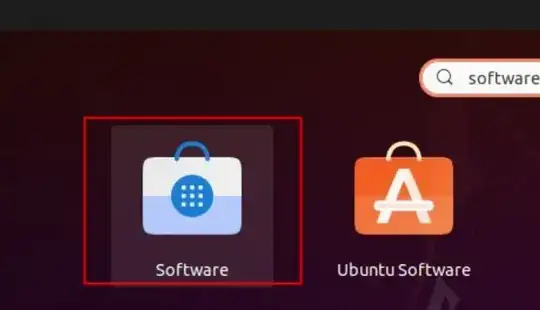

Visually in your system you can see:
Image Credit: How to Install Gnome Software as Ubuntu Software in Ubuntu 20.04
Click the link to find out how to change the setting.
