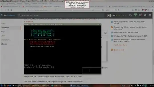

I'm trying to run a game (PRIME, an old Rougelike found here) and after downloading the 64 bit linux version, and going to run it, I get this error response:
./prime: error while loading shared libraries: libsigsegv.so.2: cannot open shared object file: No such file or directory
