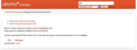

The general solution to the question “Which package provides file X?” is to use the in-packages search feature of the official site's Ubuntu Packages Search page.
Scroll down to Search the contents of packages (the second search form on the page — using the first is an easy mistake and will give frustrating results).
Enter your desired filename in the search field and hit Search, and there it is:
Screenshot of the Ubuntu Package Search page results, for a search of package contents containing "clit", showing the convlit package
