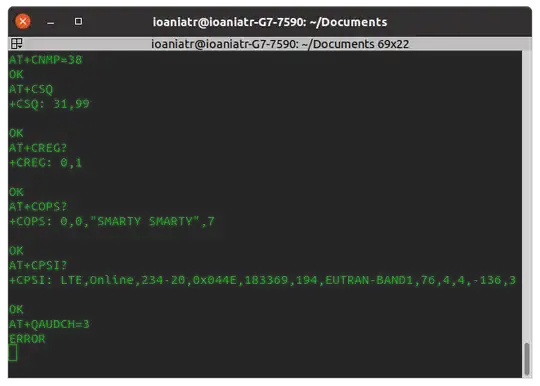

If I check on the terminal:
sudo minicom -D /dev/ttyUSB2
Minicom Check

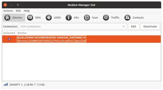

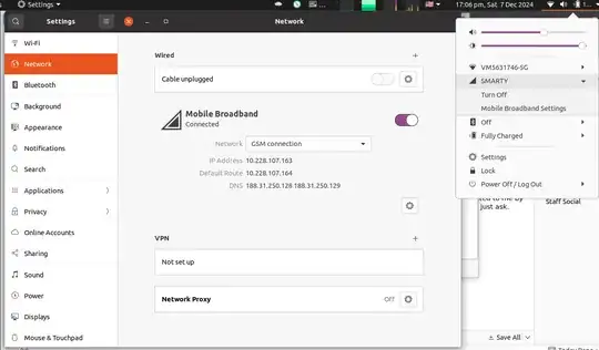

I am using modem-manager-gui for SMS, which looks simple and works smoothly with the default Network Manager by utilizing the broadband connection.
sudo apt install modem-manager-gui
modem-manager-gui
Modem Manager GUI Network Manager

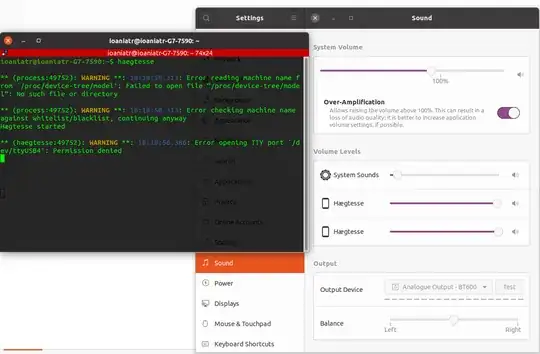

I normally initiate a call, even receive a call, but there is no sound. I have tried haegtesse that can be found here It is creating some daemon that tries to collaborate with PulseAudio, but unsuccessfully. Haegtesse
The same result with AT, it initiates a call by using ATD<phone_number>;, but no sound via USB, and I have also tried the following from a similar guide: here
AT+CPCMREG=1 // initiate PCM data transfer over the USB audio interface
AT+CPCMREG=0 // Disable PCM data transfer over the USB audio interface
AT+CSDVC=1  //Switch to earphone
AT+CSDVC=3  //Switch to speaker
Making a call with AT command: making a call with AT

  2. In the of the voice calls, you can find, there is a quite unthinkable amount of crapware. Honestly it is more hard to find such an app, as to buy a rootable Android phone! Minicom clearly shows that you could talk with the tool, but it did not answer. It lies somewhere in the driver. My first bet would be that the AT commands are only some backward compatibility feature, and to have real voice calls, you need to do some differently.
My second bet would be that the app has already locked the device.
My third bet is that the app has run on your user, but you had no access to the ttyS device. Or maybe your user had, but not the app. A short-term test could be a chmod 666 /dev/ttySomething as root. At least to check, does it work now or not. (If it works, then you can have a new question, how to make it pretty permanent with your ubuntu.)
