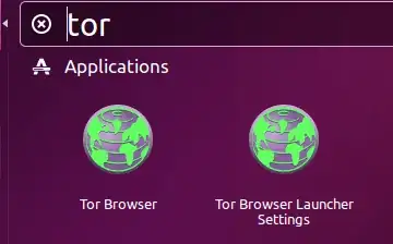

It is also apparent from your question that you did not install the Tor Browser bundle the easy way with apt as it is possible to do in Ubuntu 16.04 and later. To install the Tor Browser bundle in Ubuntu 16.04 and later open the terminal and type:
sudo apt install torbrowser-launcher
torbrowser-launcher handles downloading the most recent version of Tor Browser Bundle for you, in your language and for your architecture. After installing Tor Browser, it can be launched by searching for tor in the Dash and clicking the Tor Browser icon. The Tor Browser Launcher Settings app is also installed along with Tor Browser.
IMG:
To start Tor Browser from the terminal run this command:
torbrowser-launcher
