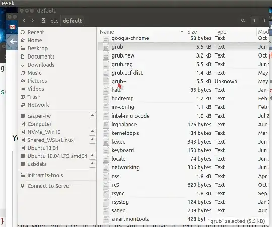

An alternative to gksu nautilus, gksu gedit or sudo -H gedit is to use the nautilus-admin add-on. It allows you to browse files and directories with Nautilus and then open them as root (Administrator).
Installation is straight forward:
sudo apt install nautilus-admin
Now when you are in Nautilus you'll have an extra option to Edit as administrator:
