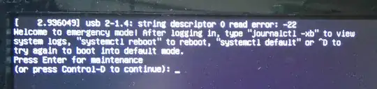

I have a dual boot Windows 10 and Ubuntu PC. After upgrading to Ubuntu 16.04 I get the following screen after selecting Ubuntu from the boot list.
I have tried the method posted here which requires booting from a bootable usb stick, running fsck -l (which shows nothing is wrong) on the root partition and rebooting, and others from this post but it didn't work. It simply goes back to the Emergency Mode.
After entering journalctl -xb I get the following output which I placed on a pastebin.
It seems like it is failing to mount the swap partition as an extract of the above log file shows:
systemd[1]: dev-sda9.mount: Failed to check directory /dev/sda9: Not a directory
systemd[1]: Failed to mount /dev/sda9.
The file /etc/fstab look like this:

# swap was on /dev/sda9 during installation
UUID=2238a8ba-5029-47d6-8276-472f1bea530e none            swap    sw              0       0
#cryptswap   /dev/sda9    /dev/urandom     swap,cipher=aes-cbc-essiv:sha256,size=256
# usb hdd for backups
UUID=34a0826c-00e4-4c65-8b28-feb34a228b55 /mnt/Ext_HD_1TB auto auto,user,rw,exec 0 0
I tried to uncomment the 3rd last line (starting with #cryptswap..) and comment out the one above. All it does is request a passphrase for the swap partition. I do not want my swap to be encrypted.

Commenting out your entries in /etc/fstab for swap partitions allowed your computer to boot properly, albeit without a swap partition.
At some point in time, you may have had an encrypted swap partition. Then somebody tried to set it to use a regular unencrypted swap partition.
Since you know how to use gparted and blkid, I'll give you the short answer on how to get your swap partition back.
  1. start gparted and delete your old encrypted sda9 partition
  2. use gparted to recreate a new swap partition in the same (now unallocated) space. If you have 4G total RAM, you can create a slightly smaller swap partition than the 8G partition that you have before. Make it 4G.
  3. select the newly created swap partition and right-click on it and select the swapon command. This will temporarily enable swap.
  4. in terminal, type sudo blkid and note the UUID for the newly created swap partition (it may, or may not, be sda9).
  5. in terminal, sudo gedit -H /etc/fstab and find the commented out line
    #UUID=2238a8ba-5029-47d6-8276-472f1bea530e none swap sw 0 0
    remove the #, and change the UUIID to the one that you got from the blkid command. Save and quit gedit.
  6. reboot, and confirm that a swapon command properly shows your swap enabled.
