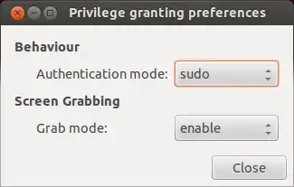

If you decided to install gksu and are using the 64-bit version you'll need to run gksu-properties once to set the authentication to sudo. There is no need to do this on 32-bit as it's set to sudo by default.
