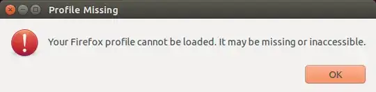

So, does this matter. I wasn't sure, so I ran firefox, like this:
tim@Hairy14CVB:~$ firefox
(process:4959): GLib-CRITICAL **: g_slice_set_config: assertion 'sys_page_size == 0' failed
Error: Access was denied while trying to open files in your profile directory.
And this ugly error:
For the full terminal output (including firefox babble), see these two pastebins, here and here.
