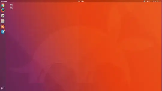

I have the same problem after upgrading from Ubuntu Gnome 17.04. I tried a lot of fixes, but none of them helped me. I decided to reinstall Ubuntu. After a fresh install, the issue still persists, but there is a kind of workaround that is working for me. As described here: In terminal execute export XDG_CURRENT_DESKTOP=Unity then run the app ./Telegram & exit. The result is a litte bit bigger icon in the tray and a badge indicator on the icon in the dock. enter image description here

You have to edit /usr/share/applications/telegramdesktop.desktop which is telegram launcher. Change line
Exec=telegram-desktop -- %u
to
Exec=env XDG_CURRENT_DESKTOP=Unity telegram-desktop -- %u
You can do the same workaround for Slack too.
