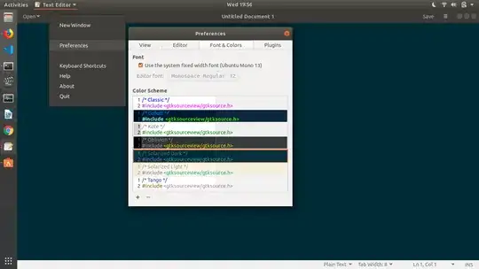

if you are using GNOME 3, you can access the preferences via the top menu.
you should have "activities" on the top left corner of your screen. on the right side of activities, you will have gedit. click on it, and you should see the preferences.

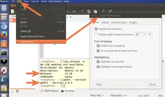

Just type Alt+E, then again E when you are in gedit. A new window called "gedit Preferences" should appear.
gedit preferences

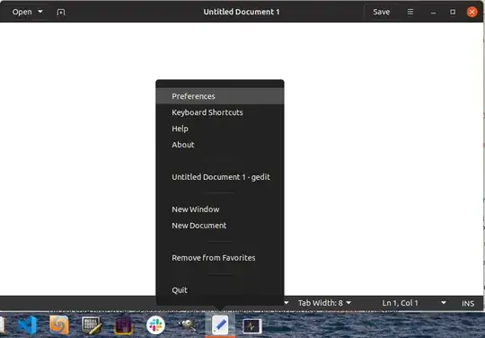

Some preferences, such as display line numbers can be activated from the options in the gedit bottom bar(right side).

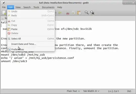

The preferences are under edit at the bottom of the list. enter image description here
Try to get the menu-bar back, or if that fails remove it entirely and install a fresh new instance of gedit, mine is 3.10.4, so yours is a bit old!
