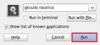

Method 1:
  • Press ALT+F2 and enter gksudo nautilus and then click Run.
    alt text
  • It will open nautilus with root previleges.
  • Goto Filesystem var www and now you can add/copy/paste your files.

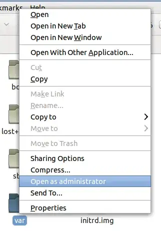

Method 2:
  • Install nautilus-gksu Install nautilus-gksu
  • After installing type nautilus -q in your terminal to refresh right click menus.
  • Now you will find 'Open as administrator' entry in your nautilus right-click menu.
  • When you need to open any files with root permission, you just have to right-click on that file/folder and select 'Open as Administrator'.
  • It will open that file/folder with root permission.
    alt text
