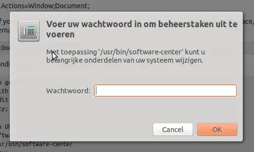

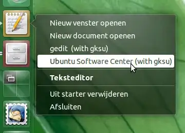

A convenient way is to create a dedicated .desktop file, or add your commands to an existing one, asking your password via GUI (gksu). In the example below, I add the command to run Gedit and Software Center with sudo privileges to the Gedit launcher. You will need to have gksu installed to use this setup: sudo apt-get install gksu
  1. Copy the Gedit .desktop file in/usr/share/applications/to~/.local/share/applications`:
    cp /usr/share/applications/gedit.desktop ~/.local/share/applications/gedit.desktop
    and open it for editing (drag it onto an open gedit window)
  2. Look for the line: Actions=Window;Document;
  3. Add the names of your commands to the line (these are not the names you will see in your interface, only used for internal reference in the file)
    Actions=Window;Document;gedit;Ubuntu Software Center;
  4. Add the corresponding sections at the bottom of the file:
    [Desktop Action gedit]
    Name=Gedit  (with gksu)
    Exec=gksudo gedit
    OnlyShowIn=Unity;
    [Desktop Action Ubuntu Software Center]
    Name=Ubuntu Software Center (with gksu)
    Exec=gksudo /usr/bin/software-center
    OnlyShowIn=Unity;
  5. Close the file and drag it onto the launcher
Now you can run gedit and Software Center with sudo privileges:
