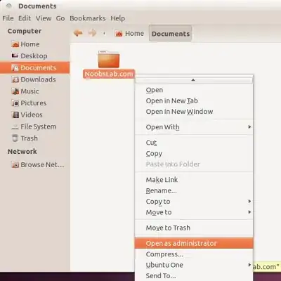

Supline
  • 173
12
To install Open-as-Administrator in Ubuntu open Terminal (Press Ctrl+Alt+T) and copy the following commands in the terminal:
sudo add-apt-repository ppa:noobslab/apps
sudo apt-get update
sudo apt-get install open-as-administrator
After installation type this command to restart Nautilus:
nautilus -q
Reboot
