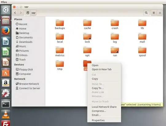

I went to /var/www to make a link, but my right-click menu is greyed out:
Why is that and how do I solve it?

"Make link" option is greyed out because the directory is outside your home directory, and you need superuser privileges to create files there. The simplest solution is to create a symbolic link manually. Open a terminal and type
ln -s <file> <link>
Replace <file> and <link> with proper filenames. <link> should be inside your home directory.
