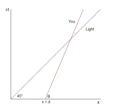

Suppose you try to outrun a light beam by travelling at a constant velocity $v$, where obviously your velocity has to be less than the speed of light. We’ll give you a head start by allowing you to start at $x = d$ while the light has to start at the origin. The spacetime diagram for the race looks like this:
Minkowski race
Figure 1
Note that in this diagram the $y$ axis shows $ct$ not just time. I’ve done this because for a beam of light $x = ct$ and therefore on my diagram the trajectory of a beam of light is a line at 45°. Anything travelling slower than light follows a line at an angle $\theta$ greater than 45°.
Hopefully it’s obvious that you cannot outrun the light and it will always catch you eventually. The faster you go the nearer the angle $\theta$ of your line gets to 45° degrees but since you can never reach $c$ the angle $\theta$ must always be more than 45° and therefore the world line of the light ray must eventually cross yours. And this makes sense. In your inertial frame light travels at $c$ so it doesn’t matter what distance $d$ the light ray starts, it will always reach you at a time $t = d/c$ so the light will always catch you.

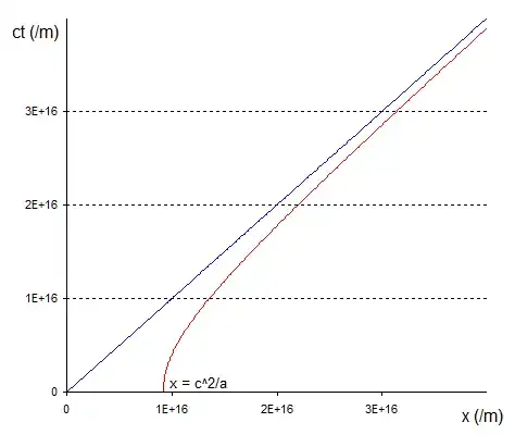

But now the fun starts. We’ll do the race again but this time you start at rest and accelerate with a constant acceleration $a$. As before we’ll give you a head start and this time we’ll start you at $x = c^2/a$. You’ll see why I chose this starting point in a moment.
Both of the articles I linked above give the equation for your trajectory in my rest frame. If we start you at $x(0) = c^2/a$ the equation for your world line is:
$$ x = \frac{c^2}{a}\sqrt{1 + \left(\frac{at}{c}\right)^2} $$
This time the spacetime diagram looks like this (this is a real calculation for a constant acceleration of 9.81 m/s$^2$):
Rindler race
Figure 2
As before the light travels along a straight line at 45° but this time your line is a curve because of course you are accelerating not travelling at constant velocity. What’s more, your world line is a curve that tends asymptotically to the line $x = ct$ so your world line and the world line of the light ray never meet.
Hang on, let’s take a step back for a moment, your world line and the world line of the light ray never meet so you can outrun a ray of light.
An observer accelerating with constant acceleration $a$ can outrun any ray of light starting any distance greater than $c^2/a$ behind them

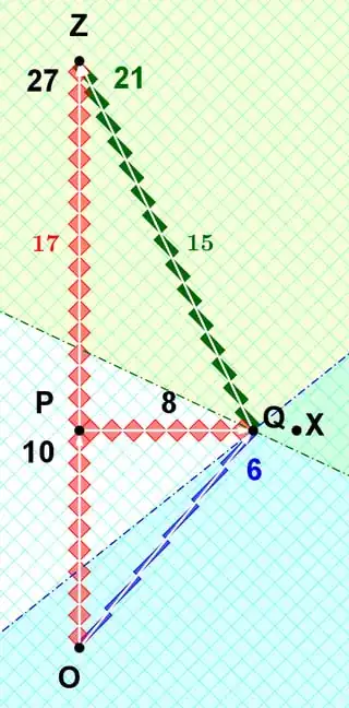

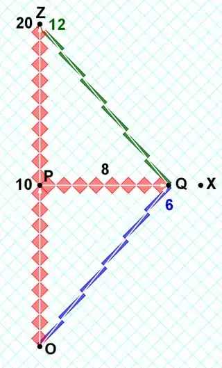

Alice stays home on earth. Bob flies from earth to Betelgeuse, and then from Betelgeuse to earth. The rookie mistake is to think that there are two relevant frames here --- Alice's and Bob's. Instead there are three --- Alice's, Outbound Bob's and Inbound Bob's.
In Alice's frame, Bob leaves earth at noon, arrives at Betelgeuse at (say) 3:00, having aged two hours, and arrives back home at 6:00, having aged another two hours. Bob's clock, obviously, runs slow by a factor of 2/3.
In Outbound Bob's frame, Bob leaves earth at noon, and arrives at Betelgeuse at 2:00, just as Alice's clock is striking 1:20. Alice's clock, obviously, runs slow by a factor of 2/3.
In Inbound Bob's frame, Bob leaves Betelgeuse at 2:00, just as Alice's clock is striking 4:40, and arrives home at 4:00, just as Alice's clock strikes 6:00. Alice's clock, obviously, runs slow by a factor of 2/3.
The thing many beginners overlook is that Outbound Bob and Inbound Bob disagree about what Alice's clock says at 2:00.

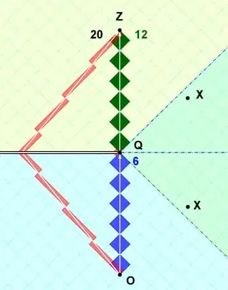

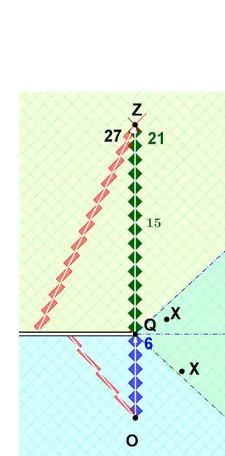

I would like to add something on the simpler version known as the Symmetric Twin Paradox without acceleration, which has been mentioned in a comment and always pops up sooner or later anyways.
Although it is constantly pointed out that the "inertial" setup is not physically consistent, for reasons of acceleration/deceleration, non-Minkovsky metric etc, beginners are often left with a nagging sense that it should be working as a toy model, hence something is missing etc, and the discussion continues ad infinitum. I think there is a useful lesson to be gained in making explicit the source of inconsistency, and some additional insight on the main question, so I'd rather add this here.
For convenience of notation, I restate the problem as follows:
Let twins A and B move at the same speed $v/c = \beta$ in opposite directions relative to inertial observer O: A in the negative direction of O's $x$-axis, B in the positive direction. Both synchronize their clocks to O when they pass by O's origin at $x = 0$, such that for this event $ct = ct_A = ct_B = 0$. Subsequently A and B continue on their respective ways towards planets $P_A$ and $P_B$, both at rest wrt to O, at locations $x(P_A) = - x_0$, $x(P_B) = x_0$. As soon as they reach their planets, both twins jump ship into new inertial frames A' and B' moving at the same speed $\beta$ wrt O, but in opposite directions. That is, A' moves now in the positive direction of O's $x$-axis, while B' moves in the negative direction. At the moment of the transfer, A' synchronizes its clock to A, such that $ct_{A'} = ct_A$, while B' synchronizes with B, such that $ct_{B'} = ct_B$. When A' and B' pass again by the origin of O, everybody compares clocks. The question is, as before, if A' and B' report the same time when they meet again at O, how is this compatible with the assertion that A/A' and B/B' must see each other undergoing time dilation and conversely?
The answer lies in a serious discontinuity brought in by the transition from frames A and B to frames A' and B'.
One way to see this is to note that although coordinate transforms between O, A, and B are immediate, given their standard Einstein synchronization, other frame pairs no longer synchronize in this usual way and the corresponding transforms are slightly different. For instance, we know that A' synchronizes with A when both pass by $P_A$, but neither clocks time at $t=0$ for this event. So how do we write the coordinate transformation between A and A'? Simple: we just account for the coordinate shifts between the respective origins by means of Poincaré transformations:
Take frame O of coordinates $(x, ct)$ and frame O' of coordinates $(x', ct')$ moving at relative velocity $\beta$. If an event observed by O' at coordinates $(x'_0, ct'_0)$ is observed by O at coordinates $(x_0, ct_0)$, then the (Poincaré) transformations between O and O' read simply $$ x' - x'_0 = \gamma\left[\left(x-x_0\right) - \beta\left(ct - ct_0\right) \right]\\ ct' - ct'_0 = \gamma\left[\left(ct-ct_0\right) - \beta\left(x - x_0\right) \right] $$ and $$ x - x_0 = \gamma\left[\left(x'-x'_0\right) + \beta\left(ct' - ct'_0\right) \right]\\ ct - ct_0 = \gamma\left[\left(ct'-ct'_0\right) + \beta\left(x' - x'_0\right) \right] $$ for $\gamma = 1/\sqrt{1-\beta^2}$ as usual. All we have to do now is identify the correct relative reference coordinates and velocities of the various frames.
It is easy to show that at the final rendezvous O-s clock shows $ct = 2ct_0 = 2x_0/\beta$, while the clocks of A' and B' both show $ct_{A'} = ct_{B'} = 2ct_0/\gamma$, as expected from symmetry and time dilation in O's view. But let us consider for example the way A and A' observe B and B':
  • Between the "departure" at O and the "turning" at $P_A$, A observes B moving in the positive x direction at velocity (see relativistic addition of velocities) $\bar\beta = \frac{2\beta}{1+\beta^2}$, and the corresponding Lorentz transforms are $$ x_A = {\bar\gamma}(x_B + {\bar\beta} ct_B) \;\;\; ct_A = {\bar\gamma}(ct_B + {\bar\beta} x_B)\\ x_B = {\bar\gamma}(x_A - {\bar \beta} ct_A) \;\;\; ct_B = {\bar\gamma}(ct_A - {\bar \beta} x_A) $$
    with $\bar\gamma = \frac{1}{\sqrt{1-\bar\beta^2}} = \frac{1+\beta^2}{1-\beta^2}$. When A reaches $P_A$ at $ct_A = ct_0/\gamma$, it observes B at location $x_A(B) = \bar\beta\; ct_A = \bar\beta\; ct_0/\gamma$. However, according to the 2nd of the above transforms, at this point B-s clock only shows time $ct_B = \frac{1}{\bar\gamma}\frac{ct_0}{\gamma} < \frac{ct_0}{\gamma}$. This is the expected time dilation as observed by A, which is good. But this also shows that when arriving at $P_A$, A observes that B has not yet reached $P_B$.
  • Between the "turning" at $P_A$ and the final rendezvous at O, A' observes B' moving in the negative x direction at relative velocity $\bar\beta=-\frac{2\beta}{1+\beta^2}$. Since we know that the 2nd rendezvous takes place at coordinates $(x_{A'} = 0, ct_{A'} = 2\frac{ct_0}{\gamma})$ for A' and, likewise, at $(x_{B'} = 0, ct_{B'} = 2\frac{ct_0}{\gamma})$ for B', the coordinate transformations between A' and B' read $$ x_{B'} ={\bar\gamma}\left[x_{A'} + {\bar \beta} \left(ct_{A'} - 2 \frac{ct_0}{\gamma}\right)\right], \;\;\;ct_{B'}-2 \frac{ct_0}{\gamma} = {\bar\gamma}\left[\left(ct_{A'}-2 \frac{ct_0}{\gamma}\right) + {\bar \beta} x_{A'}\right]\\ x_{A'} = {\bar\gamma}\left[x_{B'} - {\bar \beta} \left(ct_{B'}-2 \frac{ct_0}{\gamma}\right)\right],\;\;\; ct_{A'} - 2 \frac{ct_0}{\gamma} = {\bar\gamma}\left[\left(ct_{B'}- 2\frac{ct_0}{\gamma}\right) - {\bar \beta} x_{B'}\right] $$ But now we can check that when A' "takes over" at $P_A$ for $ct_{A'} = \frac{ct_0}{\gamma}$, it observes B', $x_{B'} = 0$, at location $x_{A'}(B') = {\bar\beta}\;\frac{ct_0}{\gamma}$, and sees B'-s clock showing time $ct_{B'} = \left(2 - \frac{1}{\bar\gamma}\right)\frac{ct_0}{\gamma}$. Since for B' the time difference to the final rendezvous is $2\frac{ct_0}{\gamma} - \left(2 - \frac{1}{\bar\gamma}\right)\frac{ct_0}{\gamma} = \frac{1}{\bar\gamma}\frac{ct_0}{\gamma} $, this is consistent with time dilation as observed by A'. But at the same time we find that $ct_{B'} = \left(2 - \frac{1}{\bar\gamma}\right)\frac{ct_0}{\gamma} \ge \frac{ct_0}{\gamma}$, which means that according to A' as it passes $P_A$, B' has already passed by $P_B$!! Conversely, due to the time jump introduced this way, the time A' observes on B'-s clock at the final rendezvous is $\left(2 - \frac{1}{\bar\gamma}\right)\frac{ct_0}{\gamma} + \frac{1}{\bar\gamma}\frac{ct_0}{\gamma} = 2\frac{ct_0}{\gamma}$, consistent with both its own clock and the point of view of O. Needless to say, the same result obtains for A and A' as seen from B an B', and even for O as seen from either A/A' or B/B'. So we are left with the following conclusion:
A/A' does observe B/B' undergoing time dilation, and conversely, as expected. But, the fortuitous switch of inertial frames to simulate a $180^o$ reversal of velocity introduces an artificial discontinuity in worldviews and time measures for the frames involved. For example, at the turning point $P_A$, A claims that B has not yet turned at $P_B$, while A' claims that B' passed past $P_B$ long ago. Neither A nor A' ever witness the actual turning of B/B' at $P_B$ (it can also be verified that A observes B' before reaching $P_B$, while A' observes B past $P_B$). Technically, it is this discontinuity of worldview that allows twins A/A', B/B' to display the same time at the final rendezvous at O, despite mutual time dilation.
As an exercise, check that a similar discontinuity is responsible for the discrepancy between the clocks of O and A'/B' at the final rendezvous, although O does appear to undergo time dilation as observed from both A/A' and B/B'.

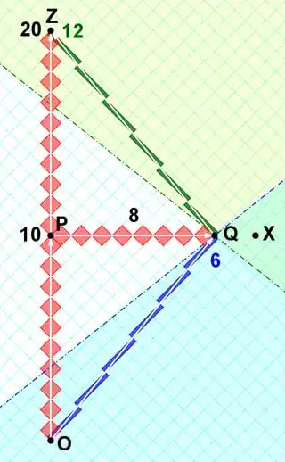

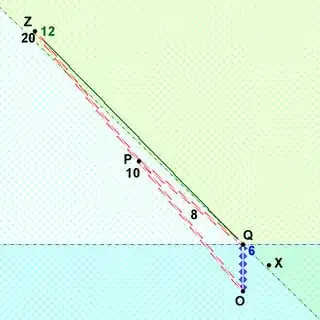

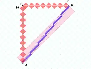

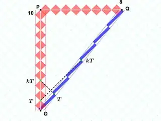

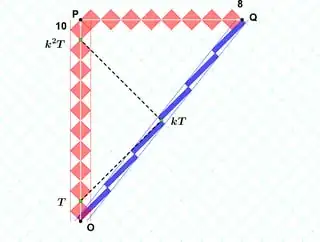

The short answer is that the situation is not symmetrical- one twin remains in their (inertial) reference frame through-out, while the other starts in one frame and ends in another. That asymmetry resolves the paradox.
By contrast, if each twin were to accelerate at the same rate to some immense distance at some immense speed, and then return to meet again where they started, provided their respective journeys were truly symmetrical they would have aged by the same amount.
The confusion arises because of inconsistencies and misunderstandings in the way different authors explain why the asymmetry causes the age difference.
The definitive answer is that spacetime is not Euclidean but Minkowskian, and the longest proper time interval between two events is that along a path that is stationary in space. However, that hardly counts as a simple explanation that is likely to be readily grasped.
The simplest non-mathematical explanation for those who are familiar with the key features of SR, especially the concept of simultaneity, is that the change is accounted for by the changing reference frame of one twin when they reverse their direction of motion to return to the other. The consequence of the change is that their plane of simultaneity rotates, and intersects the time axis of the other twin further in the positive time direction of that other twin. The shift in the point of intersection accounts for the time difference.
Arguments can arise from this, as some commentators assume that acceleration is needed to bring about the change of reference frame, while others cite the Lord Halsbury illustration with three travellers. The arguments are at cross-purpose, since what counts is the change of reference frame; how it is brought about is immaterial.
At this point I should say that those commentators who claim that GR is needed to explain the paradox are emphatically wrong. Accelerations can be straightforwardly taken into account in SR. What SR cannot do is to allow us to calculate the effects of different paths in areas in which gravity cannot be neglected.
Readers should also bear in mind that the effect is not dependent upon travellers, rockets etc, but is a property of spacetime. The elapsed time measured between two events A and B at a single spatial location in one reference frame is always greater than the sum of the elapsed times measured along other paths from A to B.

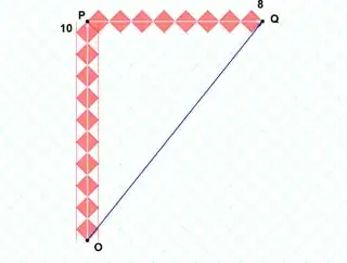

There is a mental picture I've always used for this. There are two people, the traveler and the couch-potato. As the traveler is moving away at constant velocity, he sees the couch-potato's clock advancing more slowly. Then suppose there is an event where the traveler's velocity reverses, like bouncing off a big trampoline in space.
In that instant, the couch-potato's clock is seen by the traveler to suddenly jump forward. That's what acceleration does - it makes the clocks of unaccelerated objects appear to run faster, because the lines of simultaneity are changing direction. Then, during the return trip, the couch-potato's clock appears to run more slowly than the traveler's clock, but not enough to make up for the turnaround in the center. So at the end of the trip, the couch-potato's clock is ahead (the couch-potato is older).

In the diagram below, we draw the spacetime diagram of inertial observer Alice (at rest in this frame) and her light-clock. (Time runs upwards.) The light-rays trace out on a spacetime diagram "Light-Clock-Diamonds", and this establishes a coordinate system for Alice. Her worldline is along the timelike-diagonal and her lines of simultaneity are parallel to the spacelike-diagonal.
Using Alice's grid, we draw Bob's worldline OQ (with $\beta_{Bob}=(PQ/OP)=8/10$ (for arithmetic convenience)).
RRGP-BobWL-robphy
TIME DILATION
What do Bob's light-clock-diamonds look like?
(See the diagram below)
  • Their edges must be parallel to the grid (since the speed of light is independent of the velocity of the source).
  • It turns out that the area of Bob's light-clock-diamond must be equal to that of Alice's (since the Lorentz Transformation has determinant 1, and thus preserves area, as well as the lightlike directions). [This implies that Alice measures the width of Bob's light-clock to be shorter than hers.]
    So, we get $6$ ticks along Bob's segment OQ.
    Indeed, $$10^2-8^2=6^2.$$

    (from the diagram above) One tick after separation, each sends a light-signal to the other. Each receives the signal three ticks after separation---that these reception times are equal is in agreement with the Principle of Relativity. By the way, for $\beta=8/10$, the Doppler factor $k=\sqrt{\frac{1+\beta}{1-\beta}}=3$.
    (see the diagram below) Alternatively, one can do a Bondi k-calculus radar measurement: send a light-signal at time $T$ after separation and wait for its echo. Since the echo is received at $k^2T$, one can determine $k^2$ (here $k^2=9$.. so $k=3$). There must be $k$ ticks on the segment on Bob's worldline since separation. Divide that segment into $k$ parts and draw in the light-clock diamonds, and construct a coordinate system for Bob.
    RRGP-Radar-robphy
    (see the diagram below) Yet another way, draw the causal diamond of $OQ$ and count the number of Alice clock-diamonds in it. In this example, there are $18\times 2=36$ of Alice clock-diamonds. This number is the square-interval of OQ. So, OQ has $\sqrt{36}=6$ ticks. (By the way, $k^2=(width)/(height)=18/2=9$. So, Alice would determine $\beta_{Bob}=(k^2-1)/(k^2+1)=8/10$. Further, Bob would count $6\times 6=36$ of his diamonds... and determine $\beta_{Bob}=0$.)
    RRGP-CausalDiamond-robphy
CLOCK EFFECT
Let's assume that Bob returns at the same speed.
So, Alice can splice two time-dilation problems.
We count: inertial Alice from O to Z ages 20 ticks,
while piecewise-inertial (but-still-non-inertial) Bob along OQZ ages 12.
Just a reminder, we are just drawing a spacetime diagram of their ticking light-clocks.
RRGP-ClockEffect-robphy

Suppose non-inertial Bob tries to draw a spacetime diagram (as Alice did earlier).
For concreteness, Alice's diagram could be thought of as a splicing of two time-dilation problems:
O-to-P and P-to-Z, where OPZ is along Alice's inertial worldline.
It seems natural that Bob along OQZ will try the same idea, using his lines of simultaneity, which are parallel to the spacelike diagonals of his clock-diamonds.
RRGP-Bob0-robphy

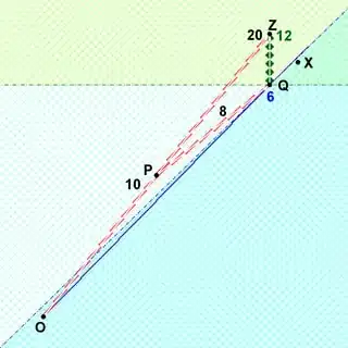

So, let's try to draw the diagrams from Bob's frame.
I'll draw the frame of the last leg QZ, then the frame of the first leg OQ.
RRGP-BobQZ-robphy RRGP-BobOQ-robphy
Then, I'll cut and splice them together.
And now we see some odd features in this Frankensteined spacetime-diagram:
  • Portions of Alice's worldline are missing, for example, event P.
    Bob's spacetime-diagram is not a full map of spacetime, whereas Alice's spacetime-diagram is.
  • Some events in spacetime appear twice on Bob's diagram, like event X.
  • Maybe... maybe, something can be done to give Bob a better, more reasonable looking spacetime diagram.... but Alice had no such issues.
    One can't claim that Bob is equivalent to Alice.
  • There is no Lorentz transformation that will straighten the kink in Bob's non-inertial worldline OQZ.
RRGP-BobSplice-robphy
