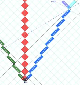

Here's a graphical method (a spacetime diagram on "rotated graph paper") that you could use to analyze various situations you might want to dream up. This should hopefully give some intuition that you might not get from just applying formulas, especially if you want to consider piecewise-inertial trips.
I've drawn a different situation in timekeeper-Chrono's frame (but I'm sure that you can change it to your own scenario) where Alice and Bob move in opposite directions with the same outgoing and incoming speeds. Chrono is the only inertial observer that is at the separation event O and reunion event Z.
I have also chosen nicer numbers so that many of the calculations are rational numbers (with $v_{BC}=3/5$ and $v_{AC}=-3/5$ so that $v_{BA}=\frac{v_{BC}-v_{AC}}{1-v_{BC}v_{AC}}=\frac{15}{17}\approx 0.882$).
(Nicer calculations occur when the doppler factor $k=\sqrt{\frac{1+v}{1-v}}$ is rational.
For $v=3/5$, the doppler factor $k=2$.
For $v=-3/5$, the doppler factor $k=1/2$.
For $v=4/5$, the doppler factor $k=3$.
You can also work backwards using $v=\frac{k^2-1}{k^2+1}$. Check it.
The time-dilation factor $\gamma=\frac{1}{\sqrt{1-v^2}}=\frac{k^2+1}{2k}=\frac{k+k^{-1}}{2}$.)
A ticking longitudinal light-clock traces out what I call a light-clock diamond.
When a longitudinal light-clock is moving with respect to the frame of the diagram, the diamonds of its clock are stretched in the frontward-future direction by the doppler factor $k$ and shrunk in the rearward-future direction by the same factor, thus preserving the area of the diamond [as expected since the boost has determinant one]).

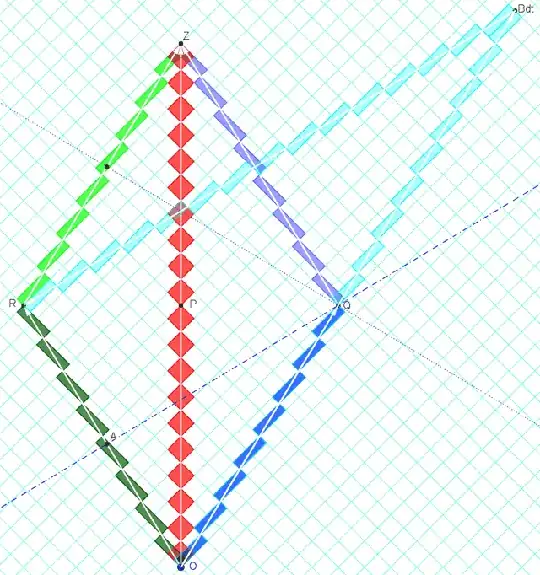

Here's the initial situation with the two travelers Alice and Bob in the "center of momentum frame" Chrono:
Note $v_{BC}=\tanh\theta=\frac{OPP}{ADJ}=\frac{PQ}{OP}=\frac{6}{10}=3/5$, $v_{AC}=\frac{PR}{OP}=\frac{-6}{10}=-3/5$ and $v_{AB}=\frac{BdtR}{OBdt}=\frac{-15}{17}$.
Note that (blue) Bob's ticks are reshaped, stretched by 2 and shrunk by 2.
When $k$ is a rational number, this is easy to draw on rotated graph paper.
Note that $\gamma_{BC}=\cosh\theta=\frac{ADJ}{HYP}=\frac{OP}{OQ}=\frac{10}{8}=5/4$, as expected.
robphy-RRGP-OppositeTwins-1
The dash-dot line QA is parallel to the spacelike-diagonals of (blue) Bob's diamonds, and is a set of events simultaneous according to Bob. (In fact, BdtR is parallel to QA. BdtR is the instantaneous displacement to Alice (at -15) according to Bob when Bob's clock reads 17.) The other dotted line is simultaneous according to Bob during his return trip.
If you want to broadcast and receive light-signals, then follow lines parallel to the rotated grid.
Two ticks after separation Chrono broadcasts his wristwatch image (reading 2 ticks) and is received by Alice when her wristwatch reads 4 ticks. That ratio 4/2 is equal to the Doppler factor and says that Alice has speed $\frac{(4/2)^2-1}{(4/2)^2+1}=3/5$ with respect to Chrono, and similarly for Bob.
Two ticks after separation Alice broadcasts her wristwatch image (reading 2 ticks) and is received by Chrono when his wristwatch reads 4 ticks (as expected by the relativity principle). Furthermore, Bob receives her broadcast when Bob's clock reads 8, which means that Bob's speed is $\frac{(8/2)^2-1}{(8/2)^2+1}=15/17$ with respect to Alice.
robphy-RRGP-OppositeTwins-2
  • So, now you have the tools to analyze what happens with regard to comparing selfies that each traveler broadcasts to the others.

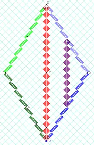

  • You can also alter the scenario. For example, 4 ticks after separation, Bob decides to assume the same speed as Chrono.
robphy-RRGP-OppositeTwins-3
For more on this approach, consult my earlier answers to
If you really want to use this to approximate your original proposed speed of $v=0.97$, use $v_{BC}=4/5$ (so, $k_{BC}=3$) and $v_{AC}=-4/5$ so that $v_{BA}=40/41\approx 0.97561$... and use several sheets of graph paper that you'll have to tape together.
