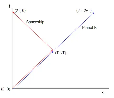

For convenience doing the Lorentz transformations let's assume that the planets A and B separate at time zero, and that the rocket launches at time zero. So at time zero all three are at the origin. Now let's identify the key spacetime points in the inertial frame of planet A:
  • $P_0: t=0, x=0$ - planet B and the rocket head off at speed $v$
  • $P_1: t=T, x=vt$ - the rocket turns round and starts heading back
  • $P_2: t=2T, x=0$ - the rocket returns to planet A
So the motion looks like:
A's inertial frame

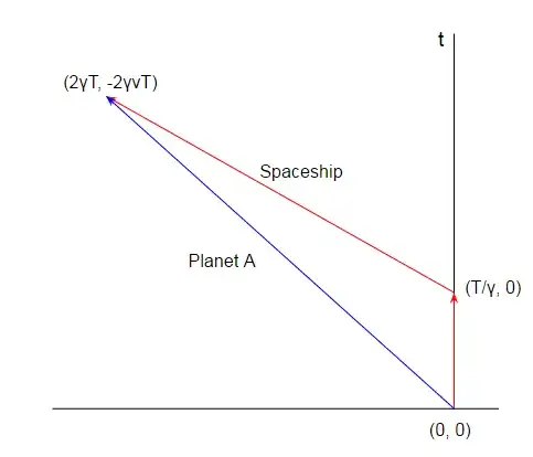

If we want to calculate the elapsed time for the spaceship we can do it using the technique described in What is time dilation really? and What is the proper way to explain the twin paradox?, but I won't do this because actually the answer to your question lies elsewhere. Instead let's use the Lorentz transformations to locate our three points in B's inertial frame. Since this isn't rocket science I'll just give the results:
  • $P_0: (0,0) \rightarrow (0,0)$
  • $P_1: (T,vT) \rightarrow (T/\gamma,0)$
  • $P_2: (2T,0) \rightarrow (\gamma 2T,\gamma 2vT)$
So in B's inertial frame the motion looks like:
B's inertial frame
Note that in B's inertial frame the two legs of the rocket's journey last for different times, which is the resolution to your problem. You are quite correct that A and B disagree about the time dilation experienced by the astronauts on the rocket, but they also disagree about how long the two legs of the journey last. The two effects cancel out so that A and B will agree about the elapsed time on the rocket.
Assuming you looked at the questions I linked you'll know that the elapsed time for a moving object is just the length of its trajectory, and that the trajectory length is the same whatever frame you use to do the calculation. So A and B must agree about the elapsed time on the rocket.
