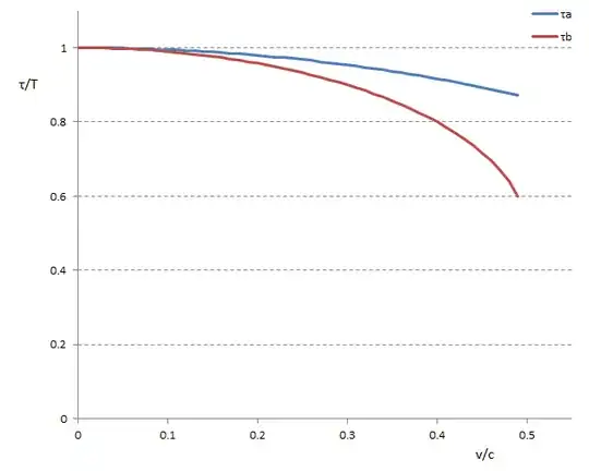

It's a little hard to compare the equations (1) and (2) to see which twin has the shorter proper time, so I've graphed the ratio $\tau/T$ for both twins for a range of speeds up to $v = 0.5c$ - $v$ can't be greater than this otherwise twin B would be moving faster than light:
Proper times
You can see immediately from the graph that twin B has a smaller proper time than twin A for all speeds greater than zero, so twin B has the greater overall time dilation. What is happening is that B has no time dilation for the first half of the experiment, but for the second half B's time dilation is more than twice A's time dilation. The end result is that B ends up with a greater total time dilation.

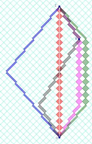

However, in general, one has to compute the elapsed proper time along each worldline, e.g. using a calculation or possibly graphically, as below.
Think of "age" as "elapsed wristwatch-time [proper-time] along a worldline",
akin to "distance-traveled" as "odometer reading along a path in space".
robphy-RRGP-multiple-paths
from my answer to How Does the Multiple Traveler Situation or Paradox Relate To The Twin Paradox.

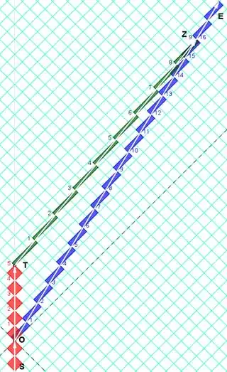

To more directly address the scenario you described, here's a spacetime diagram (drawn on "rotated graph paper") of your scenario (with more convenient relative velocities).
Since nothing is sacred about using twice the first twin's velocity, I have chosen velocities $v$ from 0c, (3/5)c, and (4/5)c. These have corresponding doppler factors $k=\sqrt{\frac{1+v}{1-v}}$ of 1, 2, and 3 [which are rational, and are thus associated with Pythagorean triples].
We have drawn the ticks of traveler-proper-time (as traced out by a light-clock carried along a piecewise-inertial worldline-segment).
  • The doppler-factor helps us draw these "light-clock diamonds" by stretching a grid diamond [a light-clock diamond for the diagram's rest frame] by $k$ in the forward-future direction and shrinking by $k$ in the backward-future direction (which preserves the slope of the edges (speed of light) and the area of the diamond (since a boost has unit determinant)). [Areas of causal diamonds are equal to the square-interval of the diagonal.]
    So, we have 3 inertial-frames depicted on this diagram used by these 2 piecewise-inertial travelers.
    [In the earlier diagram, there are 5 inertial-frames used by 5 piecewise-inertial travelers (one of which is inertial).]
So, inertial-trip OZ logs 16 ticks, whereas piecewise-inertial OTZ logs (5+9=)14 ticks. This is essentially the clock-effect with unequal outgoing and incoming relative speeds.
In this portion, "OZ is preferred" because OZ is inertial. A boost can make OZ vertical on a spacetime diagram that faithfully represents all events in spacetime.
This can't happen for OTZ. (Why? See my answer https://physics.stackexchange.com/a/507592/148184
to What is the proper way to explain the twin paradox? )
So, by counting,
traveler SOZE logs 20 ticks, whereas the late-but-will-catchup SOTZE logs 18 ticks.
Neither traveler is "preferred"... one just has to (in general) add up the proper-times along the various segments.
Of course, you can certainly use formulas and handle more general situations.
But, to develop some intuition for relativity and spacetime physics, you can use this graphical method (which I call "relativity on rotated graph paper") to make up all sorts of situations ... and the mathematics needed to carry out the calculations is probably more accessible. (For more info, see my blog contribution: https://www.physicsforums.com/insights/relativity-rotated-graph-paper/ )
