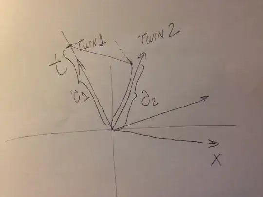

You can notice in the drawing below that the proper time, whose scale along both axis is the same, is smaller for the accelerating twin, the smaller the larger the acceleration, so that the entire path would fall on twin's 2 time axis if acceleration is infinite. $\tau$ is proper time (well, actually the greek letter that I used, which I dont rememmber in latex).The corve is the accelerated path for twin 2, which will be entirely along the t2 time axis if acceleration were infinite. So acceleration IS the explanation for the twin paradox, regardless of you denying it.
I am making this an answer, because there are too many comments which will be removed.
The basic answer is that there should not be a change in the inertial frame in order to keep the symmetry assigned to each twin, i.e. symmetries are broken when inertial frames change, as when introducing acceleration. Accelerating frames are non inertial frames. One has to delve into the mathematics of each particular case. It cannot be done with words.
In this link and the links therein , which I am suggesting for closure of your question due to duplication, you will find the mathematics. You cannot substitute words for mathematics as you are trying.
