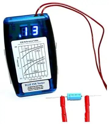

I got this device, the Blue ESR Tester Kit - Requires Assembly, because it can measure the ESR of a capacitor in-circuit, and because it's relatively reasonably priced at a current price of around $96 USD. But it's also available pre-assembled Blue ESR Tester Kit - Fully Assembly, for about $117 USD. Prices as of 1-26-2022. And it also measures shunts and resistors down to 0.01 ohm. I have no affiliation or profit from this product, and I don't know anybody at Anatek (the manufacturer). If it sounds like I'm promoting it, it's because I wish I found it sooner.
Blue ESR Tester

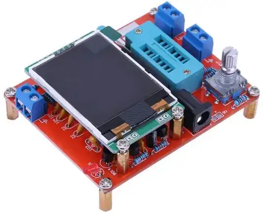

Red GM328 DIY Kit
A particular version that I like is the Red GM328 DIY Kit, which I have made several times, and costs less than $40 currently at the above link. Different incarnations behave differently, and I like this kit because I can run through a whole bunch of resistors or inductors in one run, and for putting kits together (like the GM328 kit ;-) it's great.
Red GM328 DIY Kit pic from Amazon

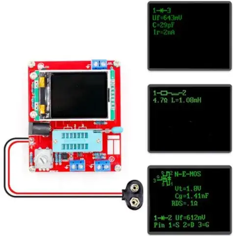

As you can see, it identifies capacitors, BJT transistors, MOSFET's and diodes, and other types as well. The inductance accuracy could be improved, but its main goal in life is identification, so that's okay. It reads frequency, generates PWM, reads voltage -- so, okay, it's the Swiss Army knife of electronic gadgets. Did I mention it's open source?
Several screen shots of the Red GM328

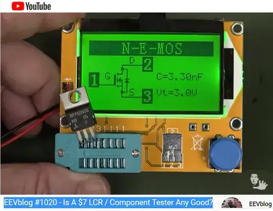

Dave of EEVBlog fame reviewed an earlier version of this device, a M328 (LCR-T4) model component tester here at EEVblog #1020 - Is A $7 LCR / Component Tester Any Good?, although I don't know if Dave ran the calibration step first, so some of the inaccuracies he reports may be overstated. Here is the EEVBlog page itself, which has more related links. This device costs less, than the GM328, even as low as $7, according to Dave.
Yellow M328 (LCR-T4) model component tester

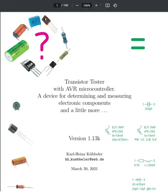

Inside the 140-page manual (pretty good) are schematics and lots of information on different modifications that can be made, upgrades, using different microcontrollers (and how to use it, of course.)
Screen shot of page 1 of manual

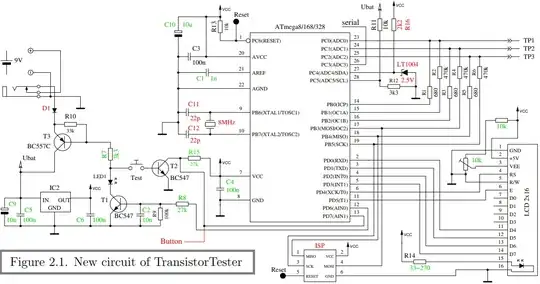

TransistorTester Schematic, Fig 2.1, from Page 11 of Manual.
