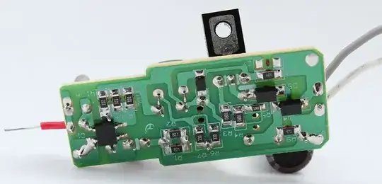

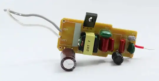

With that being said, I took apart the thing, and my first impression is impressively surprising. This bulb use better parts than all those other more expensive bulbs that I have took apart over the years. I am super skeptical whether this is really a 11w led bulb or not because counting all those SMT leds doesn't really add up to 11w anyway, and that the outer case is actually plastic, the only heat sink is that Aluminium disc. See photo below, Q1: Can this really dissipate 11 watts?
Other than that, the manual soldering connectors are crude. Not really complaining here, it should works fine. The PCB looks very nice and the parts look New and high quality to me.
I also notice there are few parallel resistors pairs, like a lot of them, which is a very cool design that I probably will be copying soon in my future project.

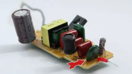

The One part that I don't really know, but I am sure that I have seen them in other PSU before, is that green round thing. Q2: what is that?

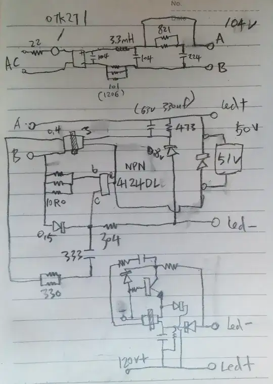

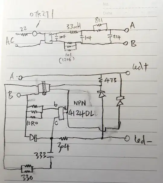

Finally, There is my trace circuit for this LED bulb. Other than that green thing (I assume it's some kind of fuse for the moment), the top part is easily understood, but the bottom part is more than confusing. I know the bottom part is a high frequency switch, but Q3: how does it really work? (Note: I am not too sure if B is C or C is B, but E for the NPN is correct.) There is also a 63v 330uf capacitor between the 473 resistor. The circuit seems very simple, but I don't really get it. It's not an isolated design, So how does it step down a 120v to 65v and less?
Update with corrections and voltage read-out: One of the diode is actually a 51 voltage zener if I am not wrong. The transformer measures 0.4:3 while in the PCB. So for Q3: How does it drop down from 104vdc (Point B) to 50vdc (Point LED-)? I don't really see a current path here. (The leds are 6 in series and 3 pairs in parallel, total 3x6=18. 3.6vX6=21.6v, but voltage read out is 50v, very strange.)

    I suspect Q2 is asking about a resettable fuse: https://en.wikipedia.org/wiki/Resettable_fuse – calcium3000 Nov 14 '17 at 22:34
    The "green thing" is likely a surge suppressor. – Misunderstood Nov 14 '17 at 22:42

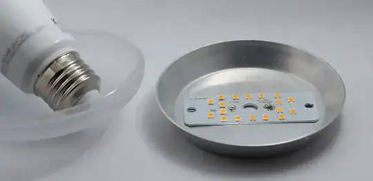

  • @Janka the bulb is very bright. I think it's 11 watts. What bothers me is whether it can dissipate all those heat via that small heatsink. –  Nov 15 '17 at 05:39

  • @laptop2d I have updated my drawing. One of the diode is a 51v zenzer. Other are 0.6v diode –  Nov 19 '17 at 00:10
  • There is no way to tell you exactly how your design works from a schematic with no part numbers. Giving you a similar was the best I could do. I put a lot of work in to that post I deleted. You are on your own. – Misunderstood Nov 19 '17 at 00:48
  • @Misunderstood I am very sorry if I have hurted your feeling and everything. I have updated the question with more detail. Yes, I put a lot of work in this too. –  Nov 19 '17 at 01:29
  • Are those 3030 LEDs? – Tony Stewart EE75 Nov 19 '17 at 04:51
  • @Tony Stewart. EE since '75 size doesn't matter! –  Nov 19 '17 at 06:37
  • au contraire, you can look up specs if you measure in mm.. I see 3.0 x 3.0 what do you get? The biggest question is junction temp of LEDs that determines aging rate and lifespan and quality of design, 2nd is dimmer compatible. 3rd is stress margin in component selection. Does your schematic make sense to you on LED current limiter? – Tony Stewart EE75 Nov 19 '17 at 14:09
  • dual LED chips are common , some are 20mA x 50V per chip – Tony Stewart EE75 Nov 19 '17 at 14:16
  • My rule of thumb is 1sq.in.surface area per watt is an adequate design , not the best. This appears to satisfy this. from 3.7" diameter est. from photo – Tony Stewart EE75 Nov 19 '17 at 14:28
  • @Tony Stewart. EE since '75 The led measures 3x2.8mm. Close to 3.0x3.0; The disc measures 88mm in diameter, and it's about 1mm thick. I have tested the led for hours in the open. the disc is finger burn hot. It's too hot for me, I think. –  Nov 19 '17 at 22:36

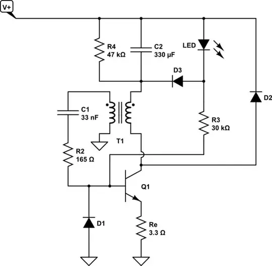

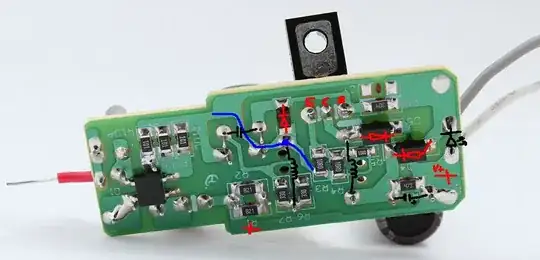

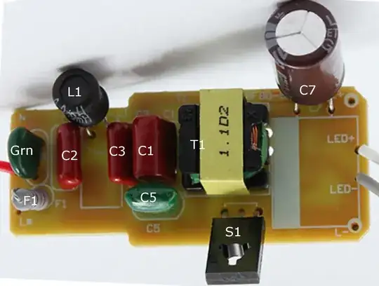

I give it a shot, and I try to reverse engineering your LED driver circuit.

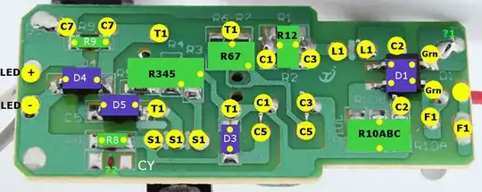

First what I did was to draw components on the PCB photo.
And now "without any problems" I could draw the circuit diagram.
schematic
As you can see we have a modified version of a single BJT blocking oscillator (joule thief).
https://web.archive.org/web/20171116125925/http://mmcircuit.com/understand-rcc-smps/
https://skootsone.yolasite.com/led-en.php
http://www.powerelectronictips.com/teardown-60-w-equivalent-led-bulbs/
Also can you post the diodes marking? So we will be able to tell exactly what type of a diode was used.
G36
  • 14,576
  • 20
  • 36
  • Part number for 3 diodes: D4=M5; D5=E51 (This should be a 51v zenzer); D3=ES1JL –  Nov 19 '17 at 22:14
  • Part number for 3 diodes: (D3)D4=M5; (D2)D5=E51 (This should be a 51v zenzer); (D1)D3=ES1JL; I have double checked your Schematic. It should be correct. –  Nov 19 '17 at 22:30

My question is about whether that tiny disc can dissipate 11 watts of power from those LEDs
I trust your measurements validate the power consumed is 11W.
6V white LEDs use 2 chips in series on the substrate.
My Rule of thumb for convection cooling is 1 sq.in/W in free air. I see the 1" Edison and estimate the heatsink approaches this metric. The only problem is the lack of free air inside the bulb with unknown surface area on the external heatsink, if anything.
