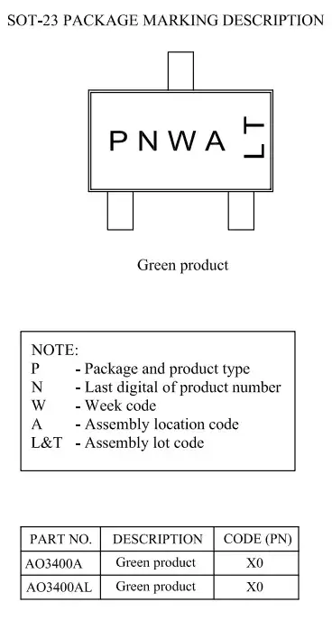

This is screenshot from Marking pdf that the company provide.
It's seems legit that this X04V 1A is AO3400A N-Channel MOSFET 30V 5.7A@Vgs=10V.
Reasons:
- The IC on your picture package is SOT-23
- X indicates its product type.
 If you take a look on A03400 (notice without "A" letter at the end) product page here on its datasheet. There are negligible differences on its spec, only \$\mathrm{R_{DS(ON)}}\$ and \$\mathrm{I_D}\$. And it's only differs by one significant figure. Also the marking of its product is "A" and not "X". I don't know in the first place why AOS build those two almost identical IC with both Full Production status.
- 0 indicates it's AO3400A or AO3400AL
- AO3400AL is the Lead-Free version. Although its not stated in the datasheet, but from other Alpha Omega Semiconductor datasheets such as here, I can see the pattern and conclude that it's the Lead-Free version. Read more about Lead-Free from other Q&A on this site here or here.
- 4 indicates the Week code
- V indicates the assembly location code (probably private internal information)
- 1A indicates the assembly lot code (probably private internal information)
