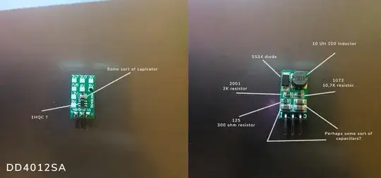

So I'm setting myself into SMD components, as I want to create my own compact 5v step down converter, based on this component.
I've read that these small brown ceramic capacitors are most likely unpolarised, to my knowledge meaning they can be turned both ways and still do their job just fine. But using my multimeter measuring capacitance, gives the result 8.400 uF and while reversed on the same capacitor gives me the result 26.60 uF.
The other capicators give me a more clear answer when measured 220 uF and when reversed 0 uF.

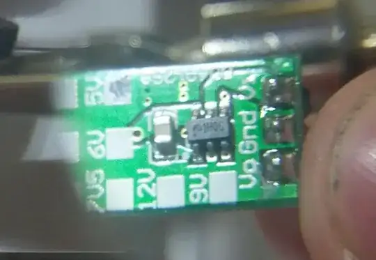

Does this mean they're polerised and can only be put in one way? I would also very much like to know which kind of chip that could be on the back on this 5v step down converter.
Chip: enter image description here

ME3116 is the IC, see the parts datasheet at the LCSC site, where you can also purchase the part: High Speed LDO Regulators.

In order to have any reliability, those capacitors need to be measured out of circuit. Desoldering them isn't to bad, as they are not very easy to damage. As for the IC, do you have a part number for the entire module? it could be an unmarked stock component or it could be a proprietary. If there is any Lettering on the IC at All(I can't tell from your photo) there are ways to look up SOT23 marking codes and narrow the possibilities down.

  • I've also added a picture of the ship, for me it seems like it has a strange symbol and then reads 1HQC or 1HOC – Artonn May 23 '18 at 17:27
  • Right now it look like a Chinese knock off of an obsolete texas instruments buck converter, which sounds about right. It's not a perfect match because the TI one is a 5pin not a 6pin – Whistler May 23 '18 at 18:45
  • So there's little to slim chance of me being able to find one, that I can use to recreate this circuit? – Artonn May 23 '18 at 18:54
  • http://www.ti.com/product/tps560430 should be a resonable facsimile, and http://www.ti.com/lit/ug/slvub52/slvub52.pdf contains some very similar reference designs. In fact the TI website has loads of reference of designs for various different load and input voltages and currents – Whistler May 23 '18 at 20:38
