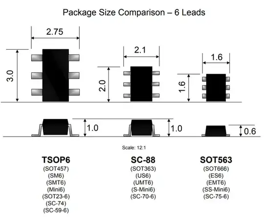

For example, here is one from ON Semi covering 6-pin packages

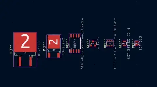

When in doubt, make one.
Using KiCad to place the desired components and then plotting the fab layer (with pad sketch) to produce the required PDF, which should print 1:1
https://smallpdf.com/shared#st=36d0795c-1b5a-4e5b-9dd6-5fab619e0258&fn=-F_Fab.pdf&ct=1615566497945&tl=share-document&rf=link

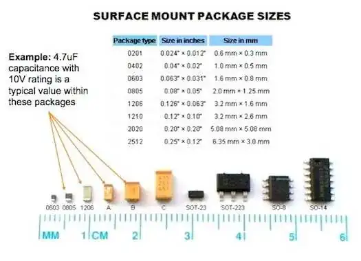

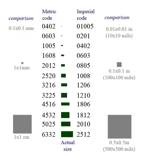

There aren't images with all smt packages just some of them, here are a few examples.
enter image description here Source: https://passive-components.eu/good-things-come-in-small-packages-a-capacitor-technology-update/
enter image description here Source: https://upload.wikimedia.org/wikipedia/commons/3/34/SMT_sizes%2C_based_on_original_by_Zureks.svg

  • thanks, that's along the lines I'm looking for, but particularly for small discrete diodes and transistors. (i've clarified in the question) – Jason S Mar 12 '21 at 16:28
