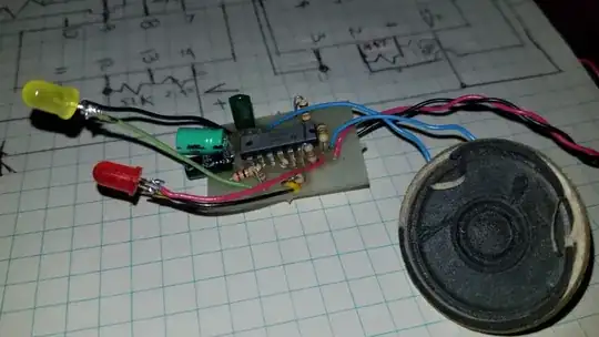

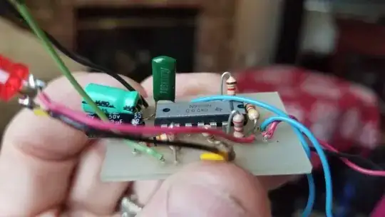

I am trying to duplicate a simple 556 circuit, this capacitor works, but when I try to substitute another cap, it doesn't work. I need to order a couple dozen of these but want to order the right thing:) tha cal in question is the flat green one with 103k in the number. I tried to measure this cap with my vom, and it read .025n. I dont know , that is accurate, since the .025n stays on my meter display with other components and wont zero out till I change away from capacitance and back again.enter )![enter image description here
Thanks,
Danenter image description here

That looks like a .01uF (10nF) 100V film cap. The code is 103K, you can find a chart of capacitor codes here:
https://tubeamplifierparts.com/handy-amp-info/capacitor-code-chart.html

    Also you'll have an easy time finding these on Mouser or Digi-Key with their filters. Just look under passive components>capacitors>film capacitors and select .01uF for capacitance and 100V for DC voltage rating.
    – Avid Pro Tool Jun 01 '18 at 02:42
