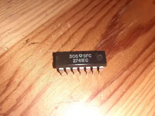

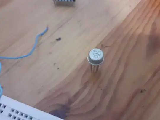

I've been given these components and couldn't find any info about them aside from a couple of Amazon articles of them stating that they were op amps.
No matter how many DIP 14 standard op amp pin-outs I tried however, these op amps just never seemed to work properly.
Assuming that they are not fried, does anyone have any tips on how to identify them?
The DIP 14 one (306 2741EC) has "S741" written on its backside if that would help.
the supposed op amp:
The supposed comparator

  • The TO-5 one may be an LM318 clone but I've never seen a "306" opamp. (LM301 yes, but if there's an LM306 it's a rarity). Or they may be something else altogether. –  Aug 06 '21 at 23:49
  • Possibly the "2741" implies a dual or quad 741? Did you already try this pinout: https://www.ti.com/lit/ds/symlink/lm148-n.pdf – MarkU Aug 06 '21 at 23:52
  • The logo (circle with internal three radial lines, or three circle segments) looks similar to the Rockwell logo; see also the canonical identification question https://electronics.stackexchange.com/questions/334128/how-do-i-identify-smd-components-or-how-do-i-identify-any-component – MarkU Aug 06 '21 at 23:54
  • @MarkU yes I did unfortunately. – A.H.Z Aug 06 '21 at 23:56
    Looks like Thompson CSF to me. Probably from the 70’s to early 80’s. They are now known as ST microelectronics. – Kartman Aug 07 '21 at 00:02

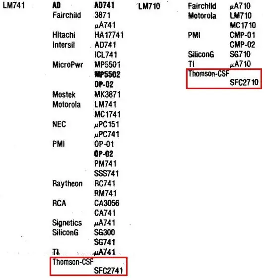

    1979 IC Master (big pdf, 183,923,985 bytes) lists SFC2741 as a second-source (clone) of LM741 op amp, made by a company called NPC (Nucleonic Products Co.) (page 863-30; page 752 of the pdf) and NPC SFC2710 as a second-source of LM710 comparator (page 845-24, page 734 of the pdf). IC master does contain some datasheets, but I don't see any of NPC's datasheets. (This big, heavy IC Master book was "the internet all printed out", before there was internet.) – MarkU Aug 07 '21 at 01:58
  • Just buy new parts from reputable dealers. – Andy aka Aug 07 '21 at 08:48
According to IC Master 1984, SFC2741 (made by Thomson-CSF) is an alternative for the μA741 op amp, and SFC710 is an alternative for the μA710 comparator.

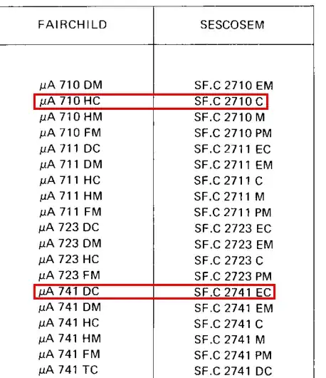

ETA: found a cross-reference that confirms these chips are equivalent:-
SGS THOMSON-CSF (SESCOSEM) Linear integrated circuits ( Circuits intégrés linéaires) 1976
