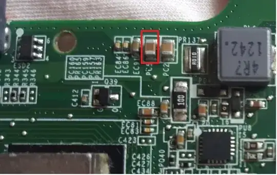

I am noobi in soldering and don't have much knowledge to identify components,
i have a lot of Capacitors and resisters, now i want to know if i need 10U 25V Capacitor from what i have stock than how i check and select correct one,
if Digital Multi Meter set to 200 Ohms range than what ohms reading it will show if i want 10U 25V?
in case if i don't have 10U 25V than what will be alternate, i am trying to fix my laptop motherboard charging section so need to replace 10U 25V Capacitor,
below is 10U 25V Capacitor which i need to replace from motherboard,
 any help will be apprenticed,
Thanks.
Thanks.

                    Also it's not clear if you want to test a damaged part (which is probably useless even if you have a multimeter with a capacitance function) or you have a mixed lot of potential replacement parts and you want to test those to find one with the correct capacitance. – The Photon Nov 15 '17 at 03:09
                    @The Photon i want to replace such capacitor coz those are responsible of charging sections so it need to test whether its got bad or not, since i checked my board as per schematic so need to replace this capacitor. – The 101 Nov 15 '17 at 03:19

                    yes capacitors are new but there is no marking on it since they are SMD capacitors so how i know if i have "10U 25V" capacitor? how do i check this with multi-meter? – The 101 Nov 15 '17 at 02:47
                    SMD components usually have markings. You might need a magnifying glass to read them though. What makes you think that the capacitor is bad? The only way to check the value if you are unsure and there are no markings would be to create a test circuit and preferably have an oscilloscope and function generator for the greatest accuracy. – CigEmacs Nov 15 '17 at 02:52
                    Of course there is another way, get a capacitance meter and test the capacitors OUT of circuit. I was assuming that you did not have a capacitance meter earlier. I think that you are more likely to have a capacitance meter instead of a function generator and oscilloscope though. Just a guess. – CigEmacs Nov 15 '17 at 03:01
                    @CigEmacs, the devices shown in OP's picture almost certainly don't have markings. – The Photon Nov 15 '17 at 03:07
                    I was actually referring to his "New" capacitors. But what new components have you ever received that don't at least have markings on the packaging as to what exactly they are? I guess that they aren't new then? – CigEmacs Nov 15 '17 at 03:13
                    @CigEmacs they are new but mixed together with other size hence my question start, when it bought, it do have mark on its little shopper but after all other capacitors mixed, i can't figure out which one is what size, so i post question for help, – The 101 Nov 15 '17 at 03:24
