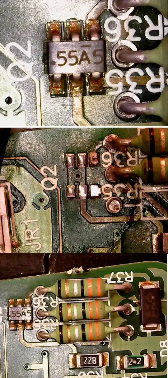

Tried all over internet...but not found what it is.
Any help appreciated.

                    4Judging by the way those 4 pads are all connected together it's probably a MOSFET of some sort. – brhans Nov 22 '17 at 13:46
                    Similar questions are asked almost daily so that's why we have a search function leading you to this question and answer: https://electronics.stackexchange.com/questions/334128/how-do-i-identify-smd-components-or-any-component Follow that procedure and if that does not provide an answer there is little hope that the component can be identified. – Bimpelrekkie Nov 22 '17 at 13:48
                    1As brhans noticed, the way pads are connected are would indicate this is a single MOSFET (or eventually BJT) in SC74 / SOT-23-6 / SOT-26-6 or variants of the like. There isn't that many of them, because usually such 6-pin packages are used for dual mosfets, but this clearly isn't the case here. So, here is a search on mouser with thoses criterias, your component could be there. Check each datasheet. Or just take one randomly and solder it. If you're lucky, it could work. – dim Nov 22 '17 at 14:20

        It might be FDC655AN MOSFET (obsolete) - replaced by FDC655BN (datasheet: http://www.onsemi.com/pub/Collateral/FDC655BN-D.PDF).

                    desqa , thank you for your answer , was very helpful. I found an other one but not sure if its the one . Seems like FDC655AN - FDC655BN you mentioned. "SST3215'' (datasheet: http://www.secosgmbh.com/datasheet/products/MOSFET/SOT-26/SST3215.pdf ). – KKostas Nov 24 '17 at 07:06
                    Yes, pinout is the same, but the marking is different - in this case it is "3215" (as mentioned on the first page). The parameters are also quite different, but it depends on your application if it matters. Good luck with the search! – desqa Nov 24 '17 at 07:13
                    I also found that the marking "55A" is used by MIC2033-55AYM6 power switch (datasheet: http://ww1.microchip.com/downloads/en/DeviceDoc/MIC2033-B.pdf). But, unfortunately, the pinout doesn't quite match up. – desqa Nov 24 '17 at 07:18
