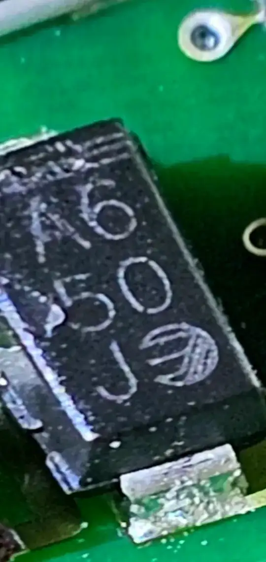

I am currently trying to repair a Bosch BMS from an ebike and found a shorted diode so far.
I can't figure out what exact model the diode is can anybody help me to identify it?

    I suggest that you change the question title from "help me find" (shopping question) to "help me identify" (information question) and add in the markings from the component so that the reader doesn't have to open the question to know what you are asking about. – Transistor Mar 25 '24 at 12:27
  • Dimensions of capsule? Where does it sit in the circuit? – winny Mar 25 '24 at 12:27

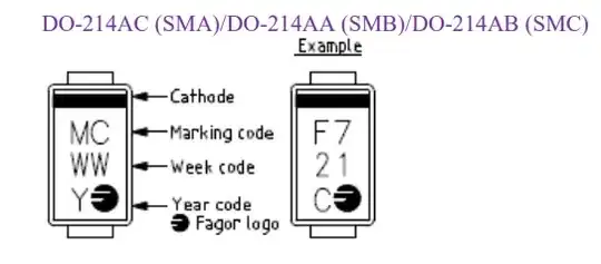

It is a FSS16 HE3 TRT* diode from FAGOR. I suggest HE3 suffix as you mentionned that your board is manufactured by Bosch (automotive).
Explanation of the marking available here enter image description here
