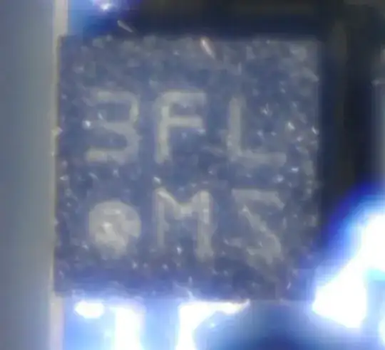

I wanted to poke around one of those sub-10$ smart bands, so I got a couple of them. I opened it and I was able to identify some major components from the SMD markings, including a Dialog DA14580 MCU, XC6206 3V 200mA LDO VReg, XT4054 Battery Charger IC, ...
This smart band acts as a pedometer, so my best guess is it's using a tiny accelerometer. There's this chip marked 3FL MS, that is either a 4x4 BGA array, or an LGA-12 / LGA-14 / LGA-16 package (I can see 4 shiny solder points under each side of the chip), and I think that's it. Sorry for the pic quality, that's the best I can do with this homemade webcam microscope.

This is a Bosch accelerometer, likely the BMA223 or a variant. Key points:
  • Recommended land pattern has four traces coming out on each of two opposite sides (and two traces on each of the remaining sides).
  • Packaging marking for the BMA223 is XXX/•MX where X are internal codes. (The M is the only thing I noticed distinguishing this from other Bosch accelerometers.)
  • 0x18 is the default address for the BMA223.
  • The 0x3F register is the FIFO_DATA register, which can be read in a burst to read the contents of the FIFO.
  • The first write to 0x18 in your trace is to 0x14, with value 0xB6, which is the software reset command for this chip.

  • Looks like a pretty good candidate, thanks. When the watch is reading the data, it starts by reading 0x0E, the FIFO_STATUS register, and the accel responds with a fill level of 0x1E or 30 in decimal, therefore the 30 bits of data when reading the FIFO_DATA reg. It starts to make sense. I'll try to poke around the 0x00 register to see if I get a chip ID.
    Just curious : did you find this chip just with the information provided and some pretty nifty google-fu or have you already worked with Bosch chips and it rang a bell ?
    – melka Nov 14 '17 at 09:07
    @melka Haven't worked with Bosch accelerometers before, though I have looked at them for some parts. After some failed googling, I found this by going through DigiKey's listing of accelerometers to see if I could find a match for the address or markings. Eventually I noticed a different Bosch accelerometer which had the right address but a different letter than "M" on the package; this let me narrow my search to only their parts. – Abe Karplus Nov 14 '17 at 09:15
